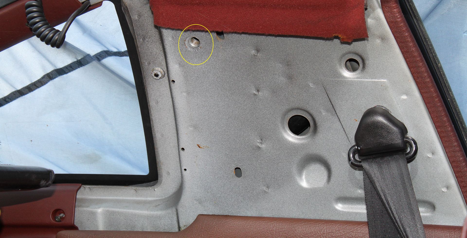

Post by ian65 » Sat Aug 24, 2013 2:19 pm
some fb's come with rear seat belts, others do not but on series 3 cars, the anchors points for a 3 point seat belt are welded into the shell at the factory...
the B post...
the bottom fixing base of the rear wheel arch....
and the buckle anchors, under the base of the back seat...
some cars don't come any rear belts, some with only a single lap belt and others with 3 point belts. There should be plastic bungs in the anchor points if they aren't / haven't been used.
I don't know if this also applies to series 1 and series 2 cars, perhaps someone can confirm?
