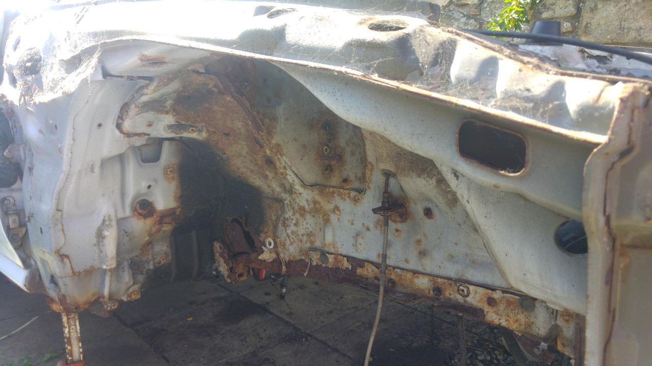

It's amazing how much work can be summed up with a couple of pictures. But I'm definitely at the stage where I can't really ignore having to cut out metal next :lol:
So in the following pictures I stripped the inner arches with a grinder back to.metal.
made up a home brew Billit Hamber detox mixture, treated the metal and rusted areas.
Cleared it off and re hit it with a grinder revealing more holes and covered the area with posphuric acid
So it has some protection now, just a quick coat of epoxy primer over the next few days if this weather holds :thumbup:

Re: White Fc Convertible
Post by richrx » Thu Mar 05, 2020 7:32 am
So my next thought is to drill the spot drills out of these tow bits of metal... See what lurks.
Can anyone advise if it's ment to be solid behind here?
And a close up of it helps
