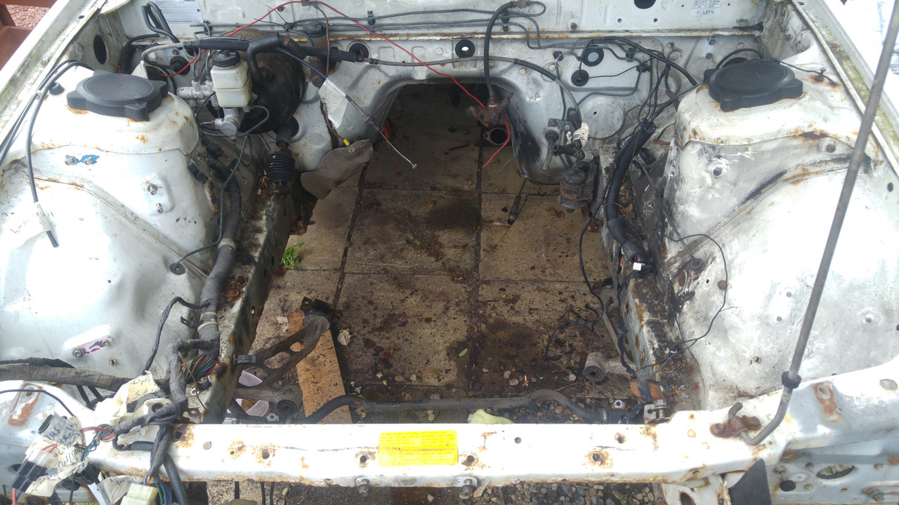

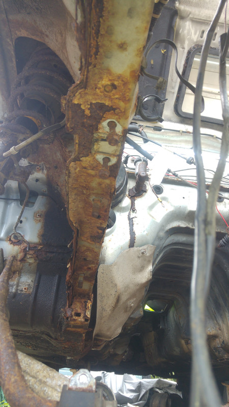

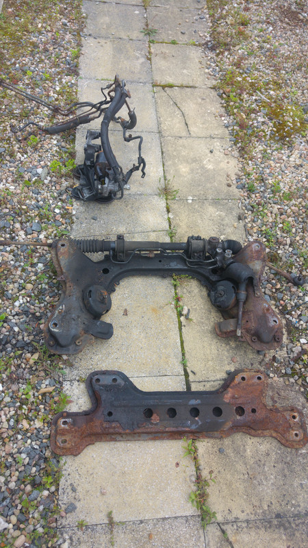

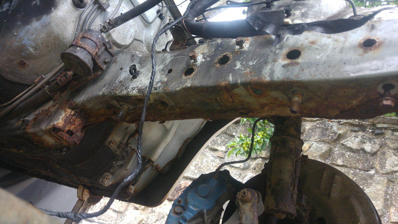

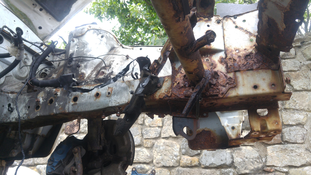

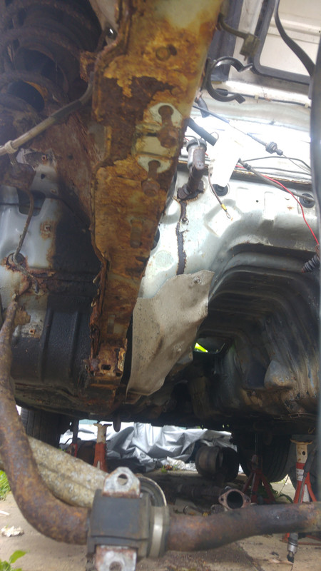

So I'm really running out of excuses not to get the grinder out now. This is the part I've been most approhensive about, the amount of rust on the front I really fear how much metal will be left. Come of the rust doesn't bother me too much even I can see how to remove and repair it.
But the inner arches at the corners and the bottom outside edge of the chassis rail give me the fear ... I think I'll pull the shocks on each side next then the wings and work with an empty arch.
I also think I'll go with Billet Hamber products they seem to have a good reputation and are always up there on the tests I've seen.
As for the progress so far, I'll post some pics as it's just more parts removed, there's really not much left on the front end .

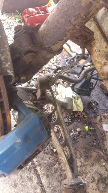

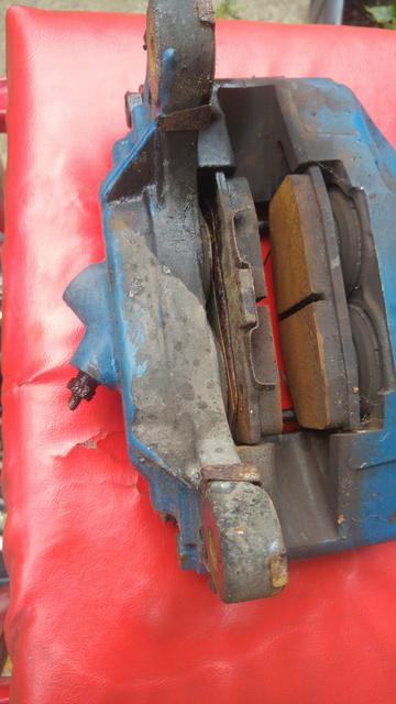

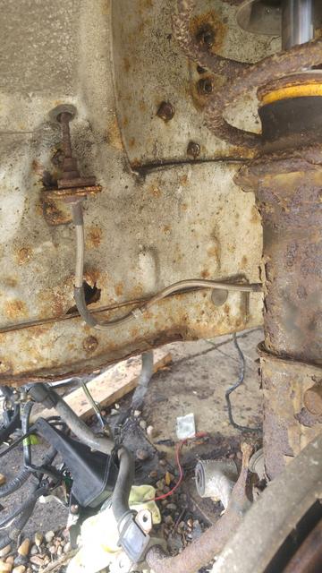

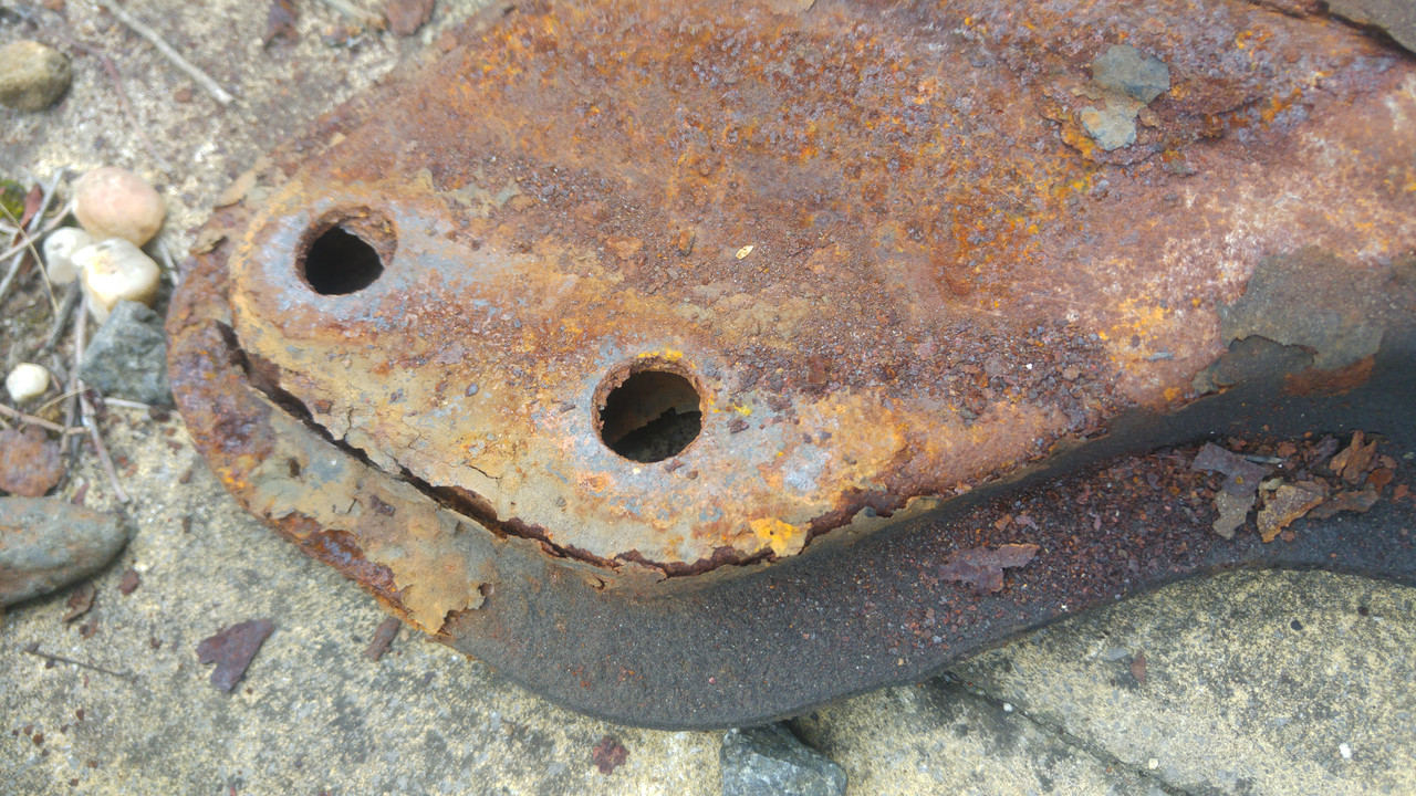

The only drama was the O/S caliper breaking free, looks like the pipe to the caliper was corroded and it's sheared through. N/S isn't looking too smart either. Lucky escape...Oh are hard brake lines to the brake calipers correct, I would have thought rubber lines would be the correct meathod between the caliper and suspension shock where it should be a hard line from this position back to brake booster ?
Thanks
Is this correct on an FC? Seems opposite to any brake system I've ever seen... Ever ..
