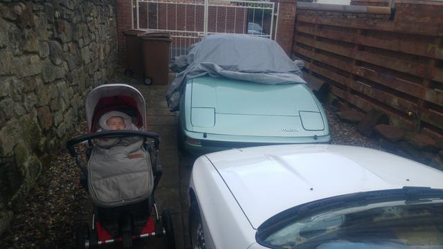

Oh here's a grousome picture of what lays ahead...

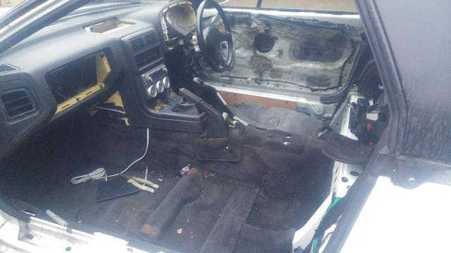

Missed your reply somehow... I want to do things as best I can, it needs 3 patches for an mot. So it could go through in the summer if I patched it up. However I want to learn more than how to bolt on pads, discs or shocks and I want this car to last a long time... So hopefully 28th advice I'll be doing a lot of preservation and prevention underneath .... The body works bad in places so will need a lot of work there to make it presentable....

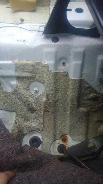

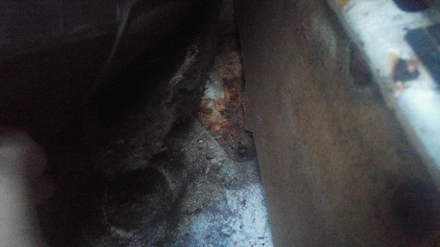

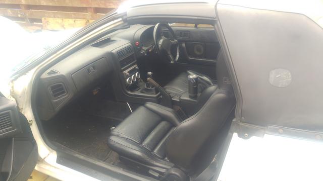

On that note, I had some spare time yesterday( Its even rarer than spare cash) so started taking the interior out and see what horrors await.

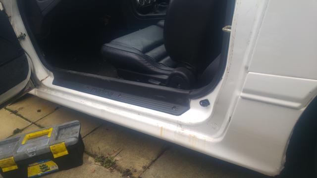

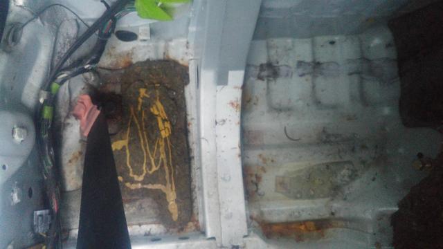

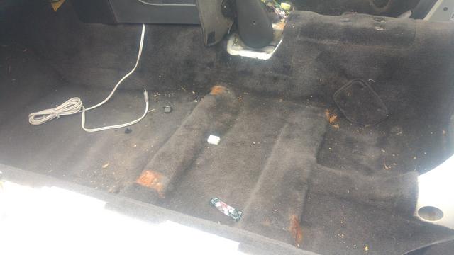

And to my surprise ( so far) nothing too scary! I would be interested to hear if what's in the pics is good/bad or average...
Rich
Ok here we go...hope the pics make sense and they're not too boring (D)

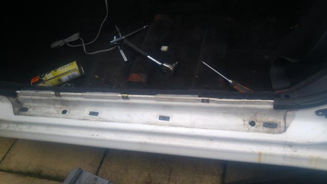

Sills look ok despite rust bleeding over the outside.
Any idea what these plugs are for? Beaten seats for a different market?

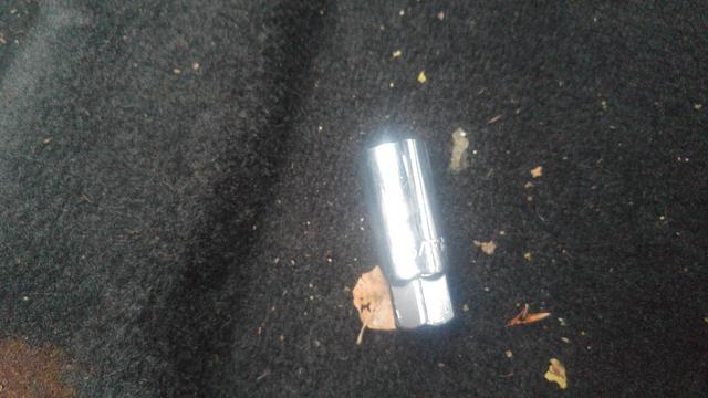

First casulty of the day, broken on the floor but to remove the seatbelt... Both appear seized solid!!

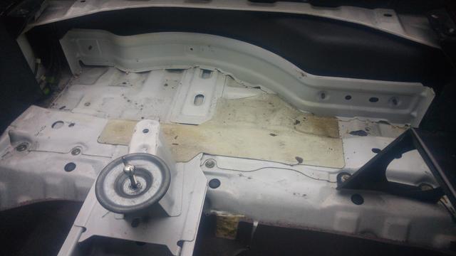

Rear seems clean?
Only rust in rear floor, the support beams look like they'll make working in the area a nightmare.

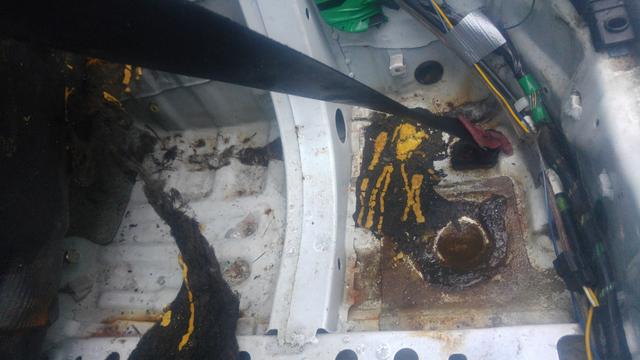

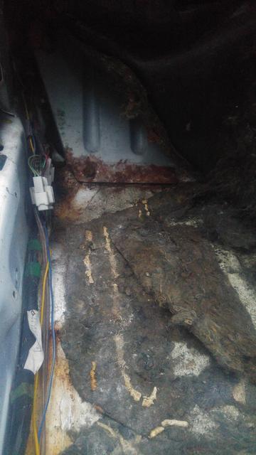

Sneak peak at passenger side so far
Possible crustyness

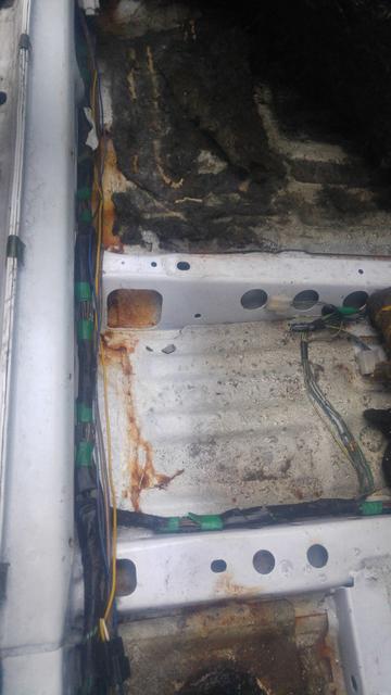

Running out of time, but drivers side ..

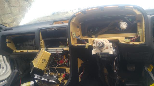

Had another few hours at it, and a helper this time too... Making the most of nap time yay dash is ready to come out, other than a black wire to the heater control box, any ideas how this is removed?
Amazing how long this takes when it's your first time... Finding all the bits!
