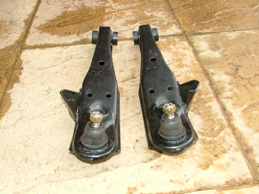

Assuming though that the bolts come out..... I usually hacksaw the rubber head off the bush each side of the control arm then drift the rest of the bush out or press it out with a G clamp.... easier job if the arm is off the car but that's another hassle because you either have to unbolt it from the bottom of the front strut or take the whole strut/control arm assembly off the car.
Here are mine with the new bushes and balljoints in...
