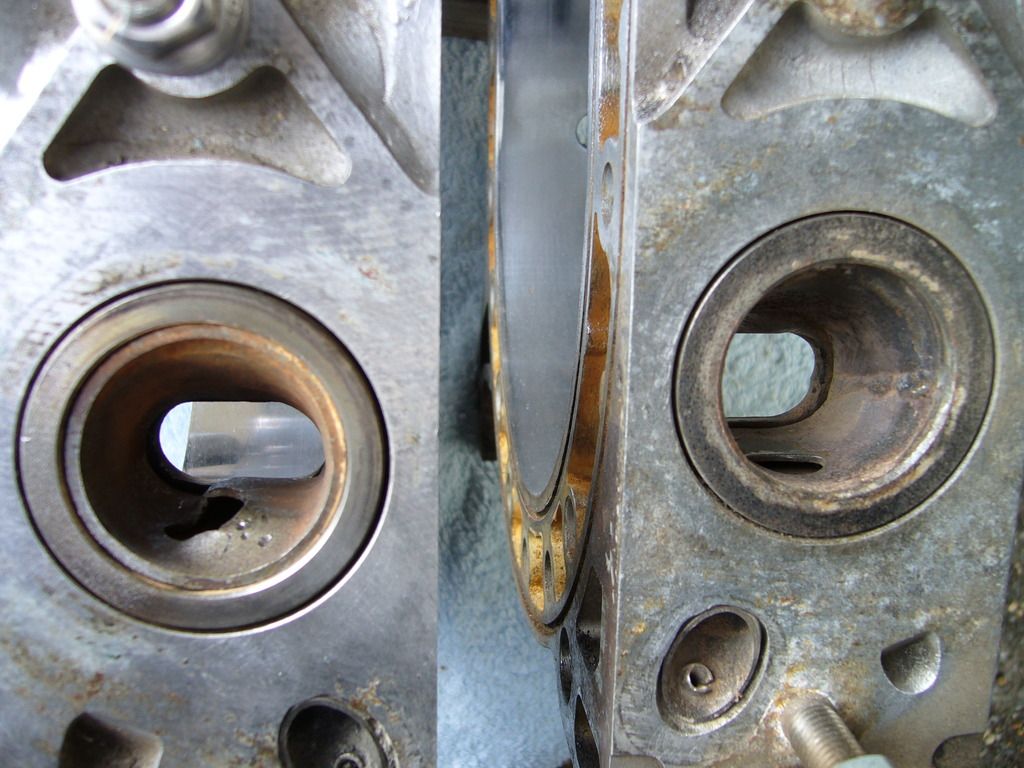

Next problem is one of my Housings has a raised lumpy hole, the other is flat.
How is the best way of making it flat, cut with a Dremmel and flatten with a punch?
Also what is best to fill the hole with? Exhaust paste/Fire Gum or some other filler?
Posts: 620
Location: Pershore, Worcester UK
Re: 12A S3 Engine Re Build
Post by gt_james » Sun Feb 19, 2017 5:48 pm

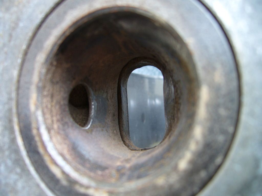

maybe I'm imagining it but the exhaust ports look different shapes? can you post a pic of the inside surface? I'm not sure about the lump in the sleeve though, maybe take it out?
Posts: 1276
Post by DKWW2000 » Sun Feb 19, 2017 5:57 pm
gt_james wrote:maybe I'm imagining it but the exhaust ports look different shapes? can you post a pic of the inside surface? I'm not sure about the lump in the sleeve though, maybe take it out?
Both ports are same size & in same position inside - "maybe take it out?" do you mean the sleeve?

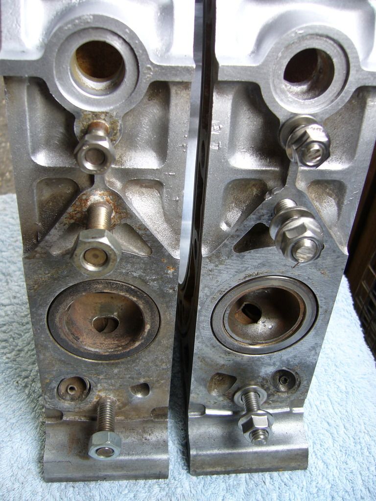

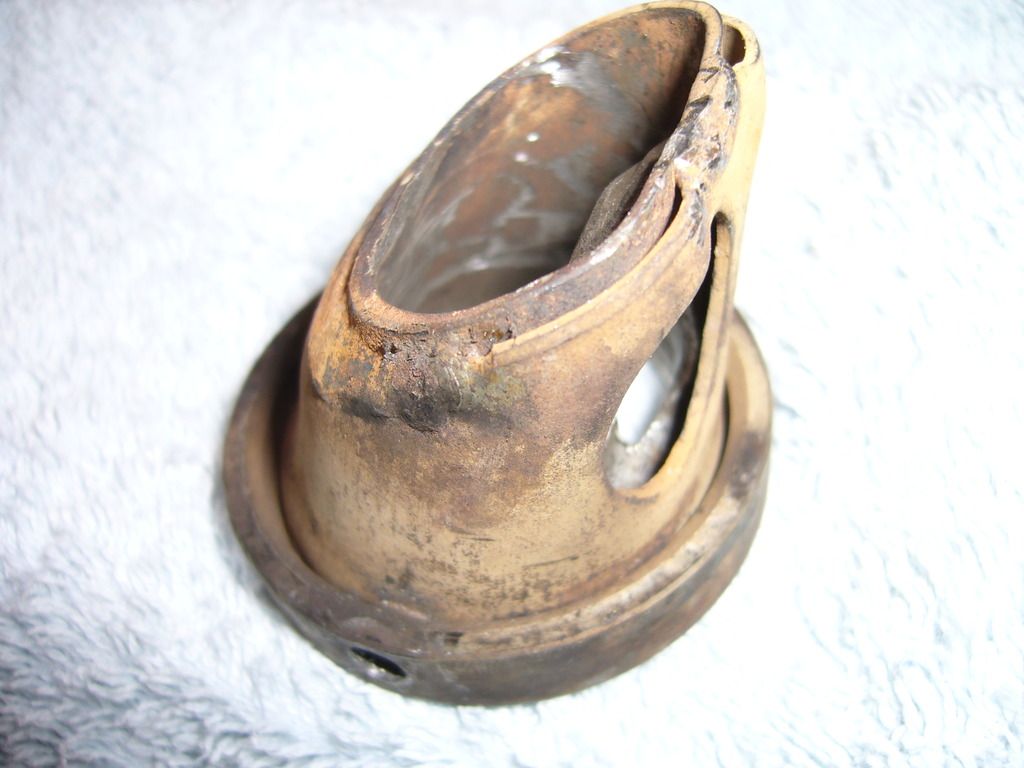

Exhaust port now sorted:-
Removed this by drilling out both Pinch Pins in side of housing:-
Replaced with a standard from a shot housing:-
Housings, Irons & Cover now nearly ready to start rebuild of spare engine rdg rdg rdg :-
