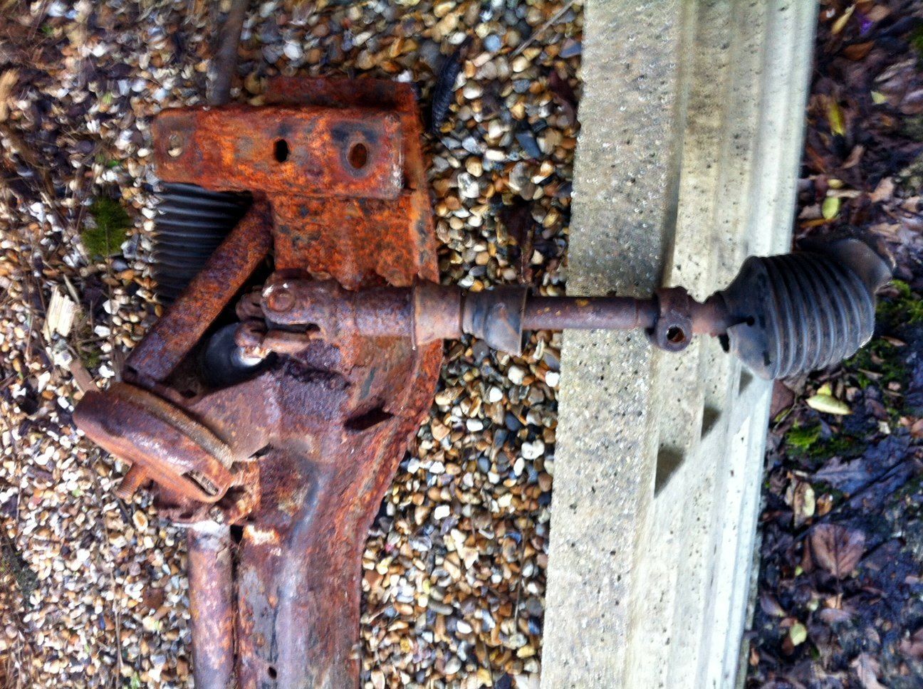

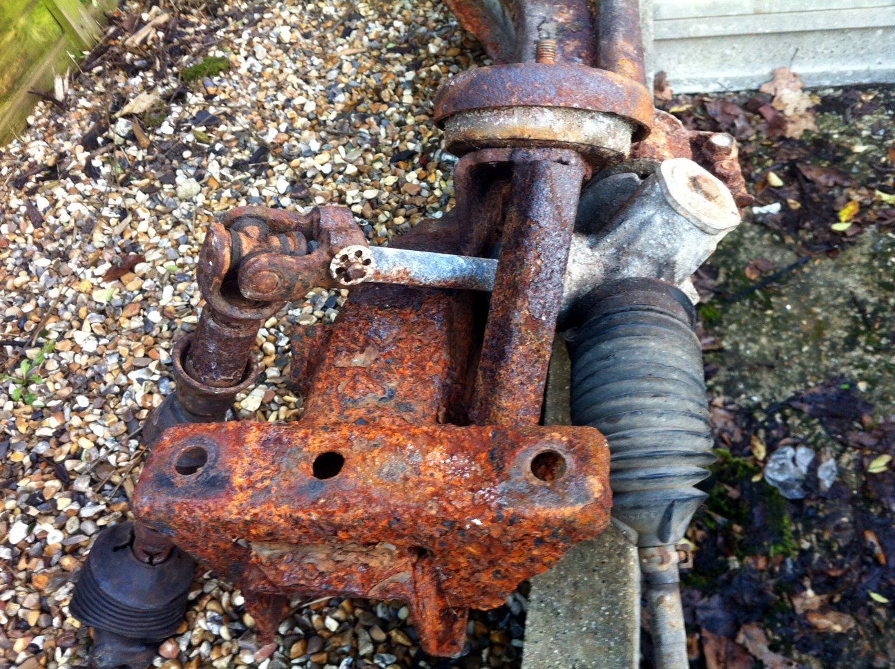

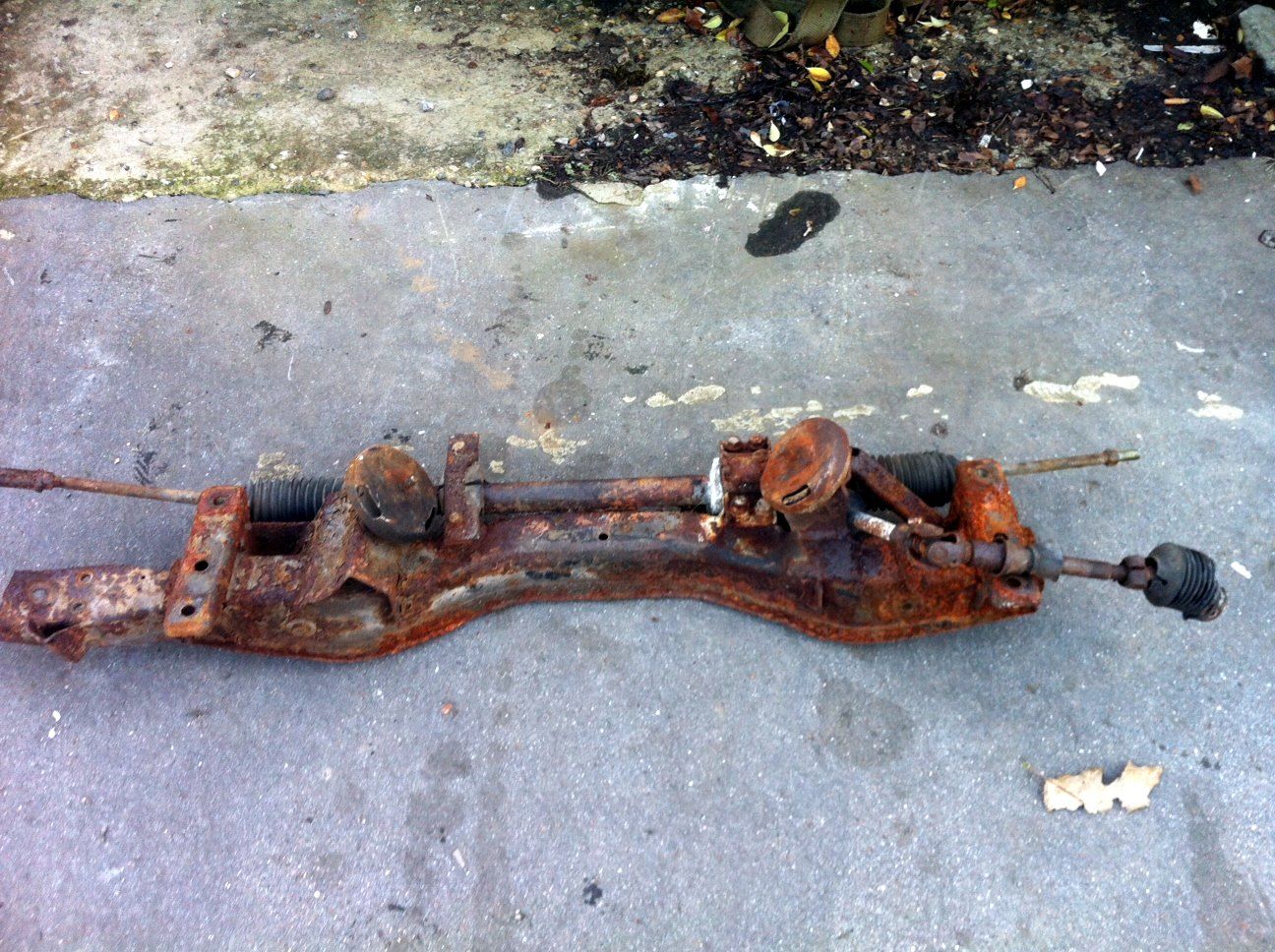

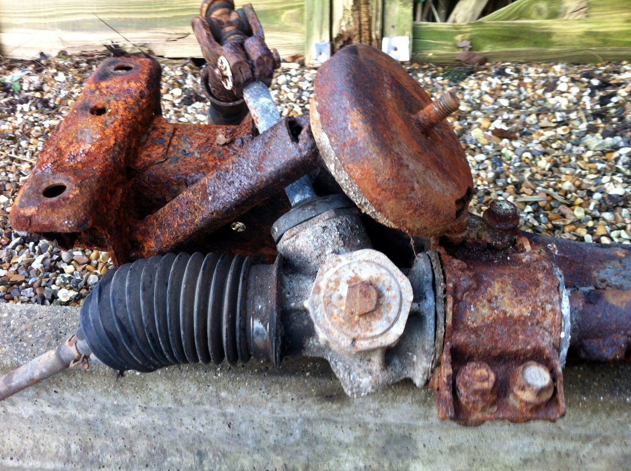

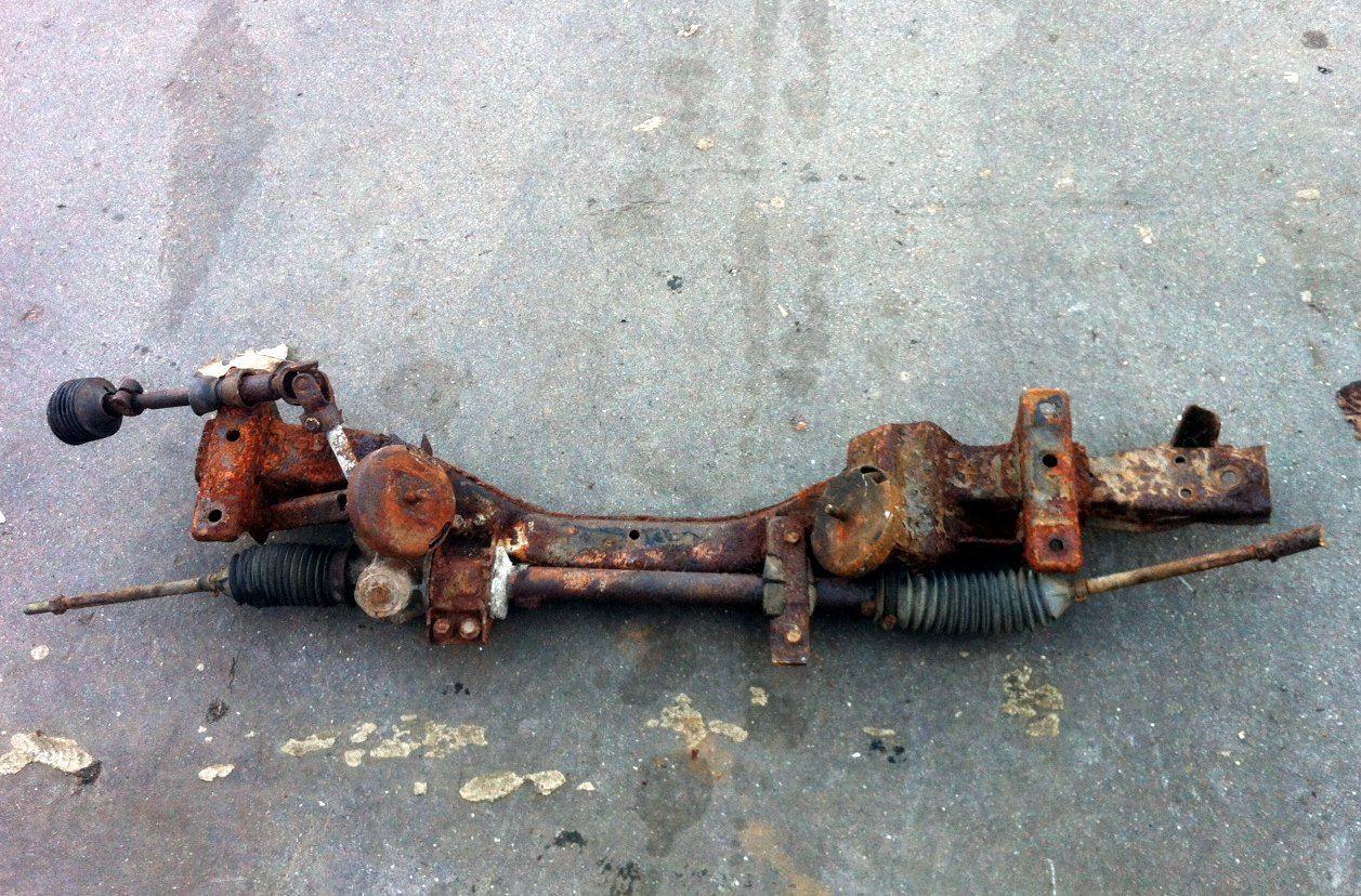

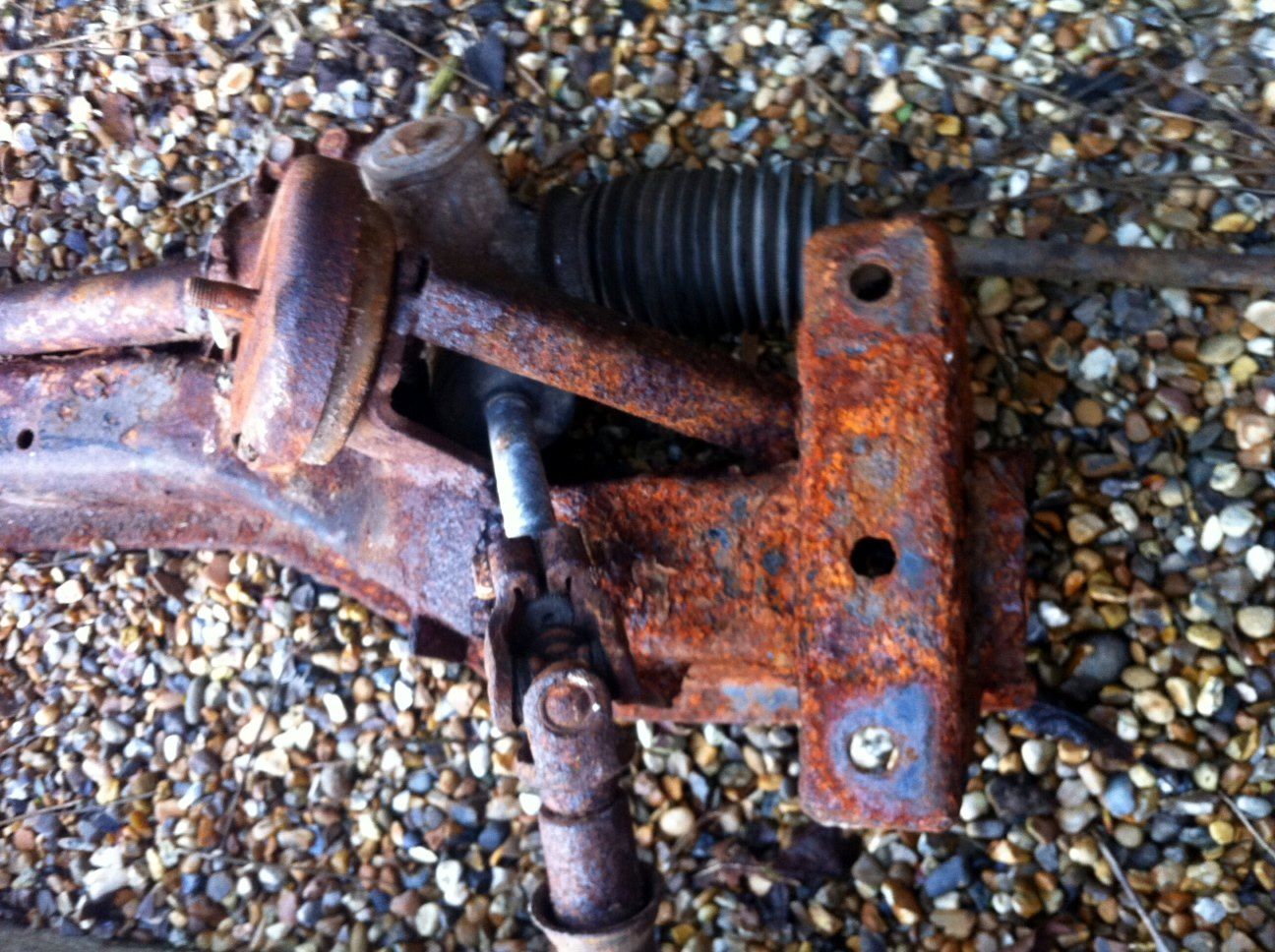

And we all remember this boat anchor:
This is a RHD FC rack fitted to the FB cross member and connected with swapped over knuckles.
Back in sunny France

ian65 wrote:it's a shame we never got to see how that boat anchor was installed... I can't quite picture it.... why was the rack fitted in front of the cross member instead of behind it like the stock drag link is?
The steering knuckles got swapped left to right, so the tie rods stuck out the front. The trick is how it was connected to the steering column.
