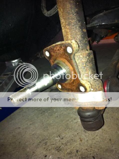

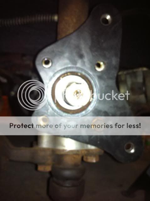

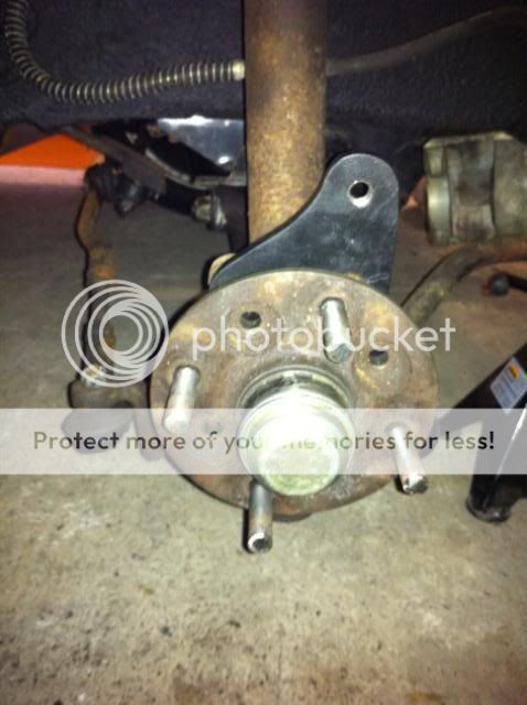

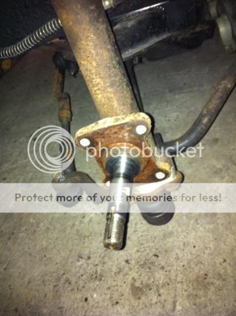

I stripped the brakes, hubs and backing plates off the struts leaving them bare.

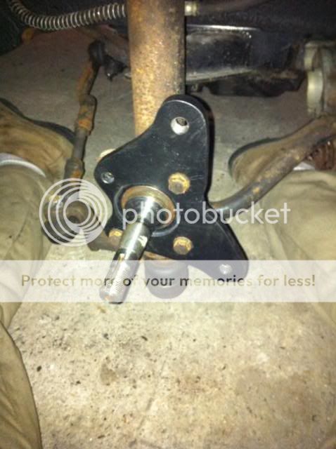

I then fitted up the custom bracket:
Note, the bracket fits snugly over the stub axle, so it is the centre hole over the stub axle that locates it. There is a slight difference between RX2 and RX3 mounting holes, so the holes can be slotted to fit either, with the bracket remaining centred at all times.

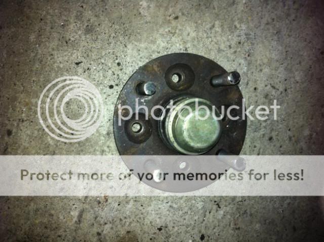

Here's the trick with the hubs, you need to machine the outer edge of the hubs to reduce the overall diameter. You only need 3-4mm off. By doing this, you can mount an FC disc over the top of the RX2 hub.
Here's the hub (note standard RX2 hub has the disc mounted onto the back of it, and uses bolts, not studs):

To mount the disc on the hub, you need to re drill the stud holes. Because the disc sits snugly over the hub, the hub locates the dics. The studs effectively stop the dics from spinning around the hub, exactly the same as other modern cars.
No pic though.

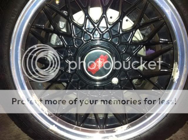

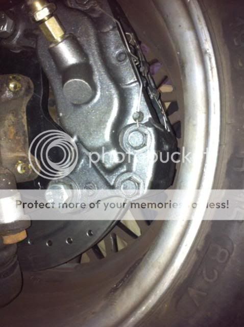

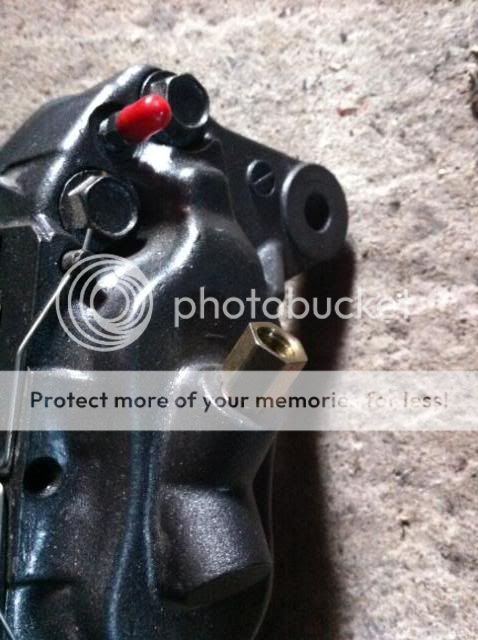

Before you mount the caliper, fit your brake hose adaptors:

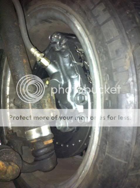

Here they are fitted behind 15 inch wheels, but some 14 inch wheels will also clear the caliper:
Painted gunmetal grey they are almost invisible.

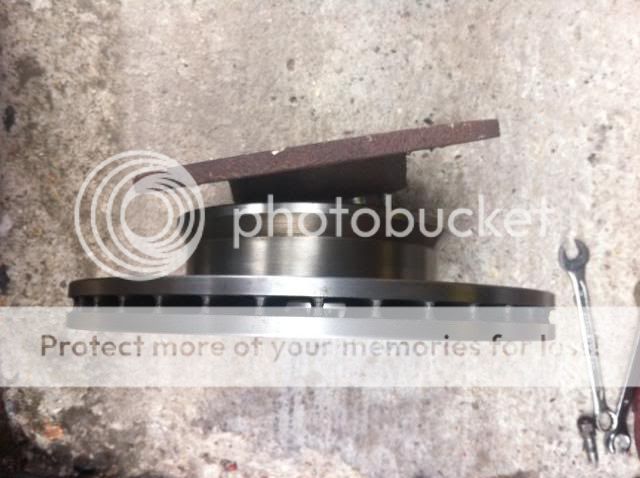

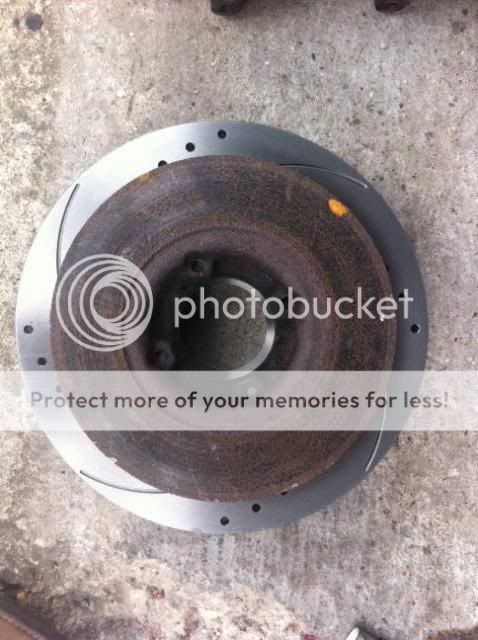

Here's the stock RX2 disc (which fits behind 13" wheels) compared to the FC disc:
Not such a big deal, you say? Here's another shot:
Back in sunny France

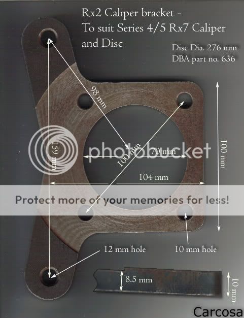

The issue you will have is getting hold of the mounting bracket.
RESpeed used to do them but we all know the company imploded when Billy left. You can still find them though.
I do have one spare set of brackets here somewhere.
Failing that, you can make your own or get someone to make you some. Here's a template:
It's for an RX2, so just check the stub axle size and bolt hole positions. This gives you the major dimensions though. Then just space it in or out based on your chosen disc.

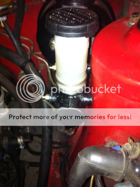

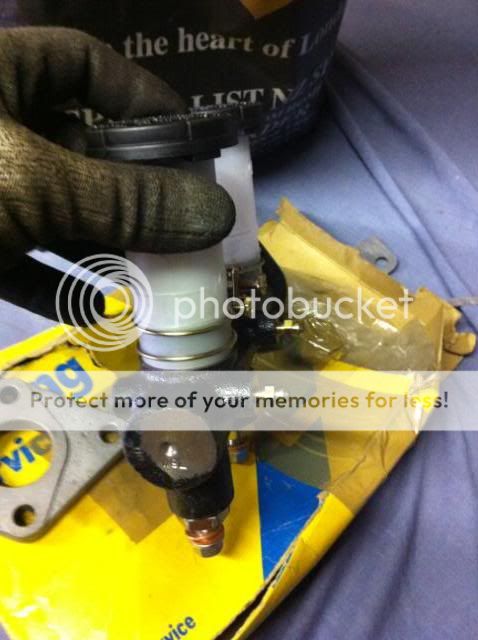

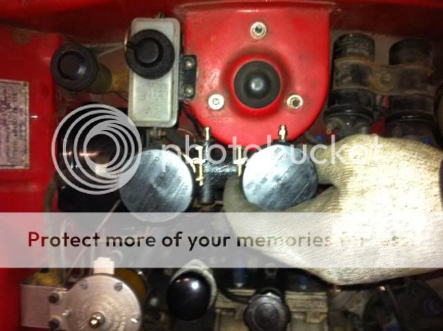

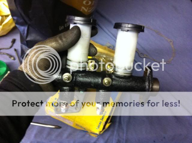

The brake master cylinder upgrade uses a Nissan Patrol master cylinder. It's a RHD unit as standard, but I modified it for LHD by swapping the nipples over, otherwise they foul on the strut tower in my car.
It's a 1" bore unit, bigger than the 13/16 or 7/8 units found in early rotaries.
Here it is:

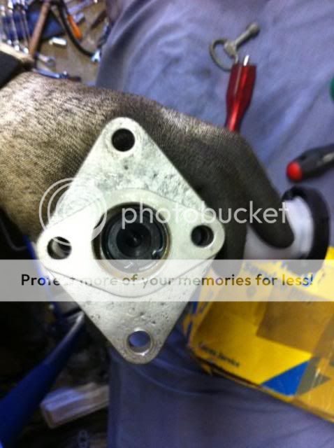

It bolts striaght onto the early RX brake booster. You just need to open up the hole for the spacer, shown here:
Or use a late RX4 unit, which is bigger.

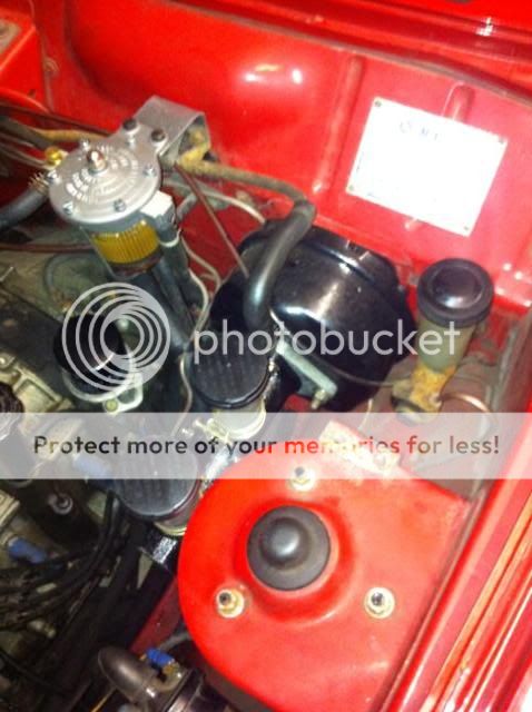

Here you can see the nipples foul the strut tower, on LHD only:
Here it is installed:
