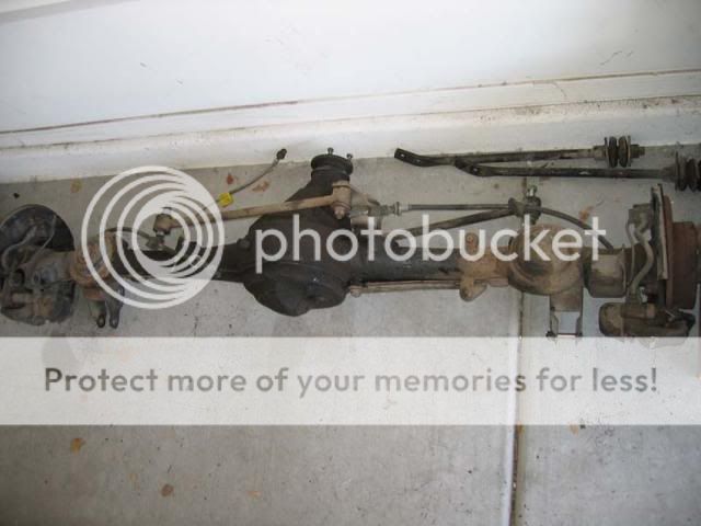

This picture shows how close the Watts link runs to the diff head on an FB:
I intend to take an MX5 type 2 Torsen LSD diff and fit it to a S3 RX7 diff carrier. I have chosen to do this rather than fit the MX5 diff directly because, apart from the issues with the Watts link clearance, other issues include the difference in ratio between an RX7 diff and an MX5 diff, the difference in length between the RX7 diff and MX5 diff and the size difference between the prop shaft flanges between RX7 diff and MX5 diff.

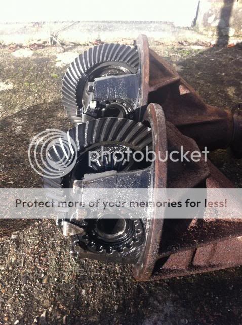

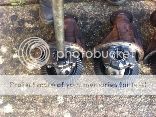

Here you can see the difference between a S2 RX7 diff and a S3 RX7 diff. Besides the difference in the number of splines, you can see the difference in the number of teeth on the crown wheel (and on the matching pinion). The S3 RX7 diff has more teeth (59:15) and the S2 RX7 diff has much less (43:11) but the S2 RX7 has bigger and deeper teeth. The S3 RX7 has more teeth to make it smoother and quieter apparently.
S2 RX7 diff in front:
S3 RX7 diff in front (so you know it’s not an optical illusion):
Here’s the crown wheels side by side. You can see how much bigger the S2 RX7 teeth are:

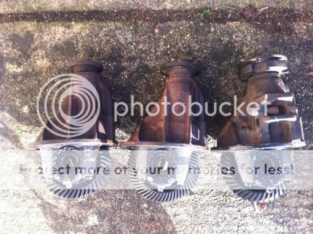

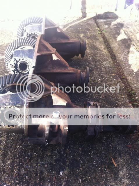

From left to right we have a S2 RX7 diff, a S3 RX7 diff and an MX5 diff. You can see the crown wheels are all the same size. 7” diffs:

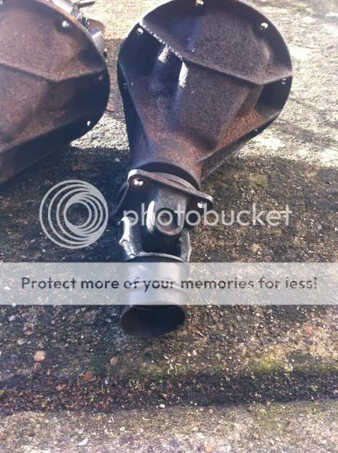

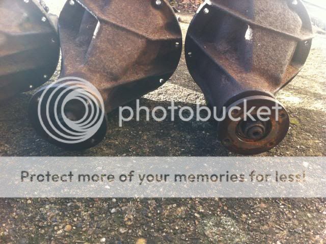

In this photo, you can see the MX5 diff (in front) is a little longer than the RX7 diffs:

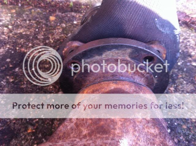

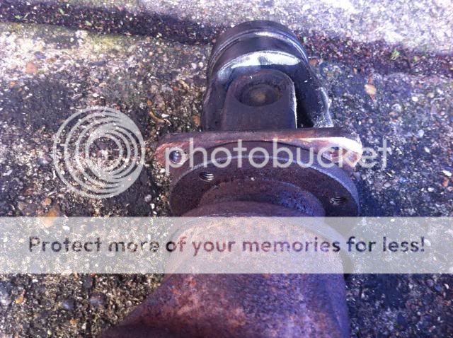

Here is a S2 RX7 and a S3 RX7 diff prop shaft flange side by side (S3 is on the left and is a little larger than the S2):
Using an MX5 prop shaft flange I have tried to demonstrate the difference between the 3 diff flanges.
S2 RX7 diff (note that the flange has threaded holes):
S3 RX7 diff (note there are no threaded holes in the flange:

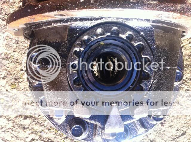

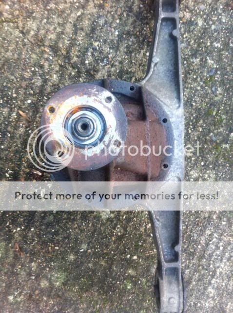

The diameter of the centre of the prop shaft is the same on al 3 diffs, so in theory you could assemble the rear half of the universal from the MX5 prop shaft onto the RX7 prop shaft, but you still have the issue of the extra length of the MX5 diff to contend with. Note, swapping the flanges from diff to diff requires removal of the pinion nut and in theory, resetting of the pinion backlash etc.

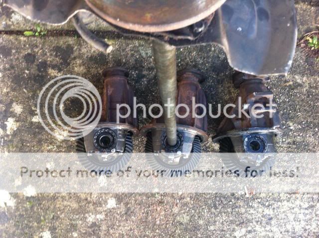

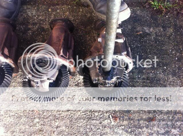

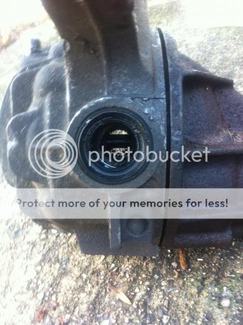

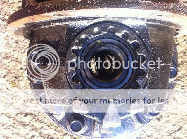

Here are some pictures of a S3 (26 spline) RX7 axle inserted into each of the diffs.
The S3 RX7 diff (small teeth on the crown wheel):
The S2 RX7 diff (large teeth on crown wheel):
The axle may look like it is inserted but it is sitting on top of the side gear and will not engage)
The MX5 diff (note the extra mounting pints which interfere with the Watts link):

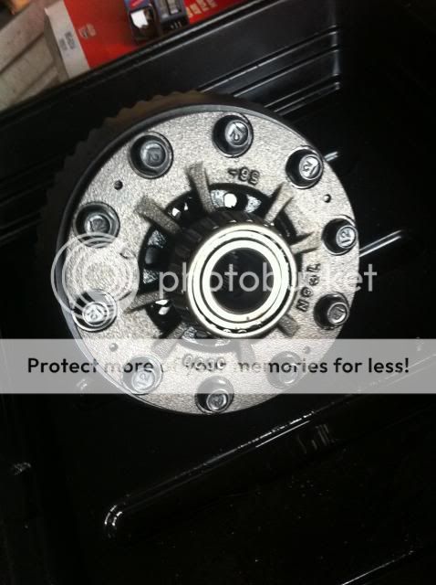

Here are a couple of shots of the MX5 Torsen LSD:

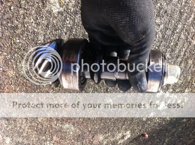

Here is the pinion removed from the carrier:
Note the collapsing collar on the shaft which is a single use part designed to maintain the preload on the pinion.

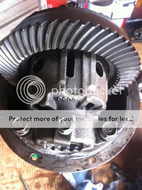

Stripping down the S3 RX7 diff.

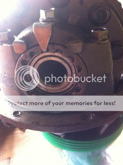

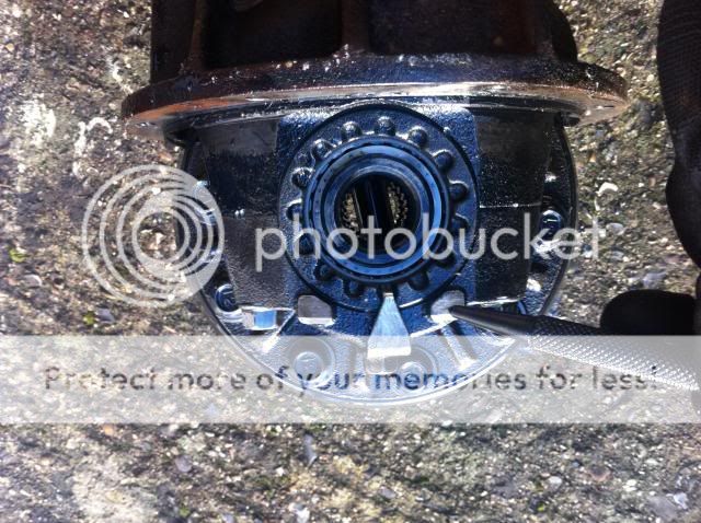

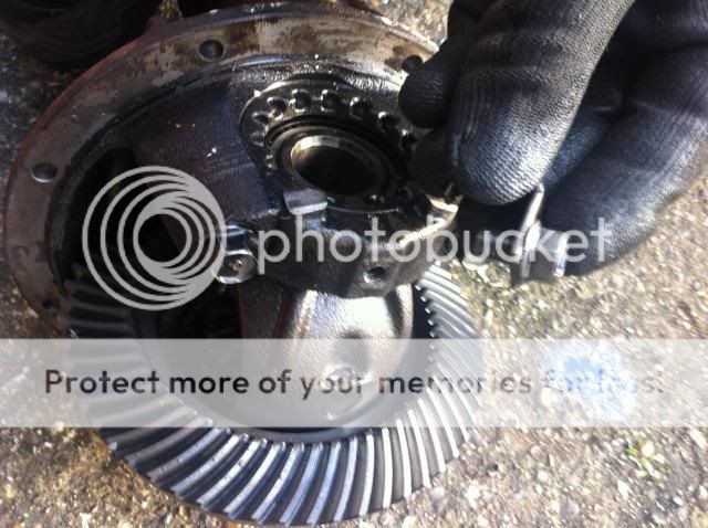

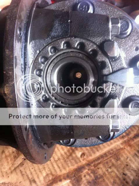

The first step is always to mark the bearing caps and bearing retainers so you can be sure to return them to their original location:
Take not of these 2 points as we will need them later on during the assembly:

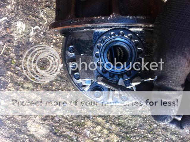

Remove the bearing retainer locking clips which prevent them coming undone:
Then you need to remove the bearing caps. I am using one of the S3 RX7 axles to brace the diff while I undo the bolts (it’s only 30 foot pound and they come off very easily):

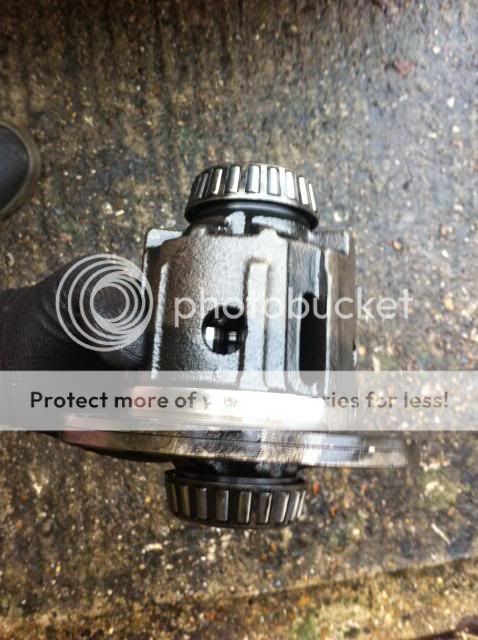

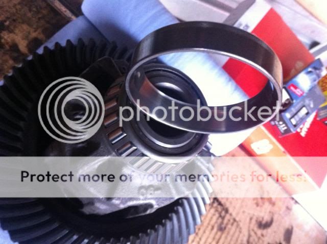

You will end up with this (this is an MX5 one but you get the idea). Make sure you keep the bearing races together with the correct bearing if you want to reuse them:

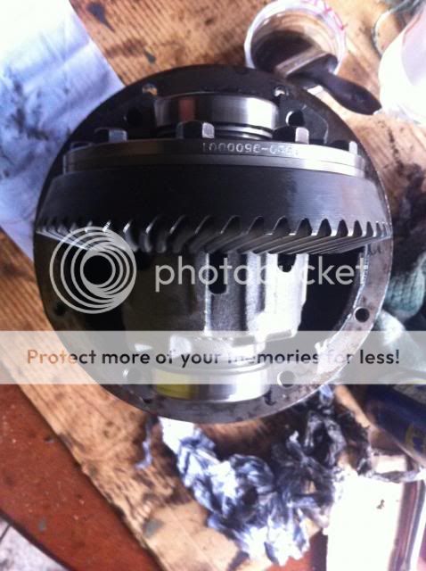

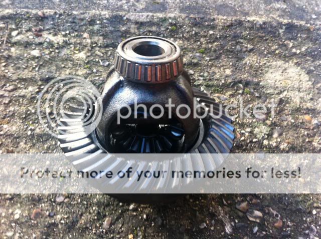

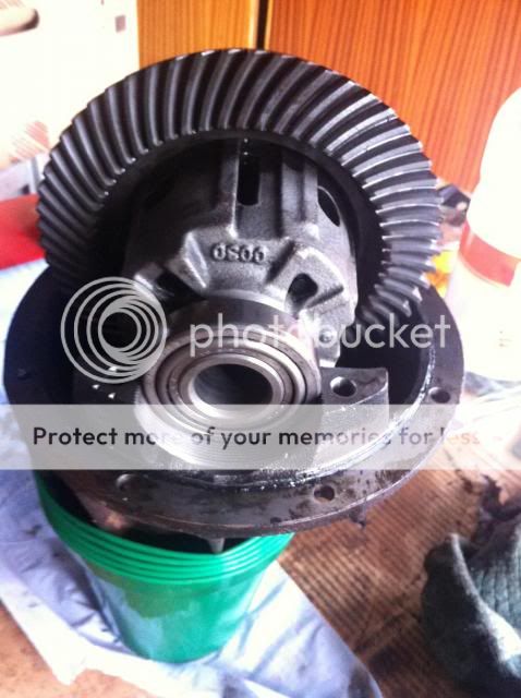

Remove the crown wheel, ending up with this:
Do the same with the MX5 LSD diff:

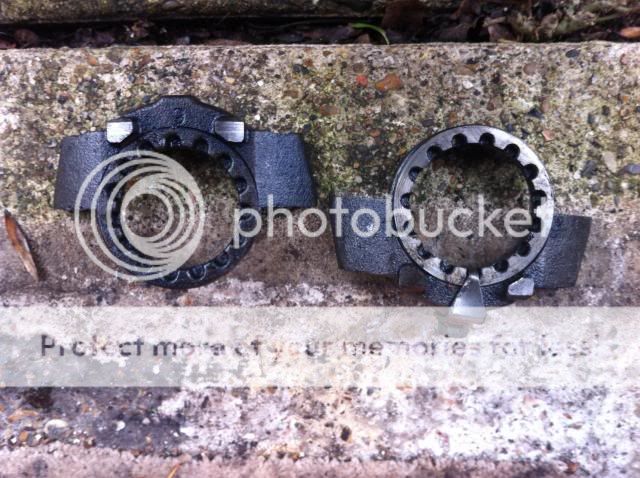

One other difference I noticed was that the S3 RX7 has a cast bearing retainer whereas the MX5 diff had machined steel bearing retainers. Here they are side by side:

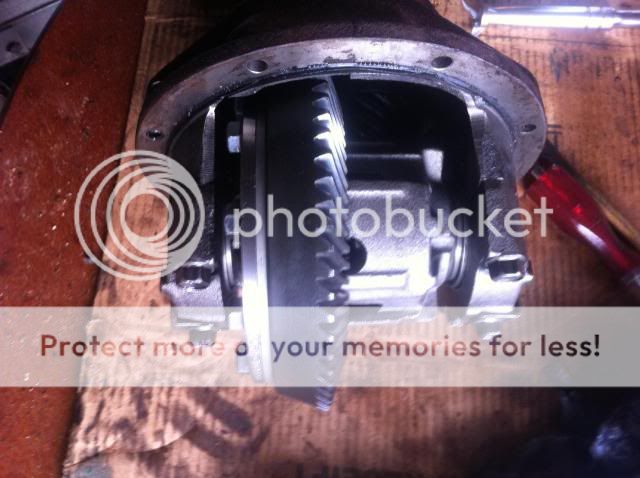

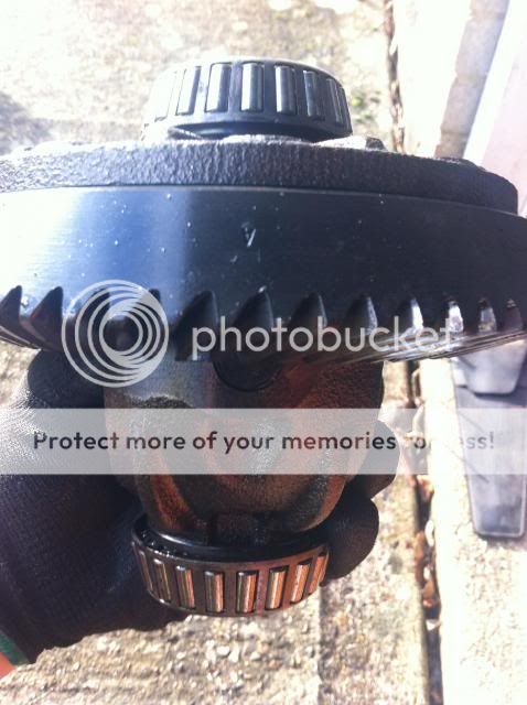

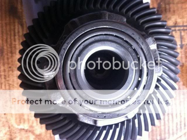

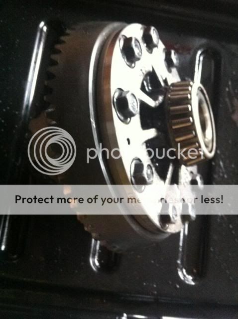

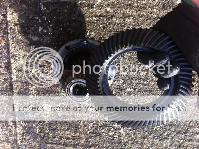

Fit the S3 RX7 crown wheel to the MX5 LSD diff centre:
Having cleaned up the bearings and inspected them, they are fine to reuse. I have made sure I kept the bearings and races together so they stay as a working unit:

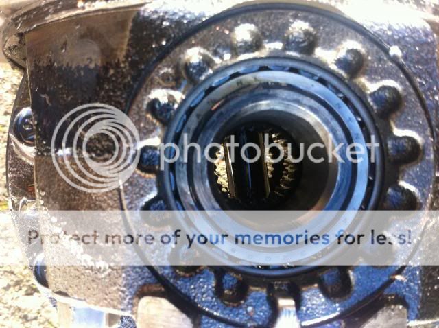

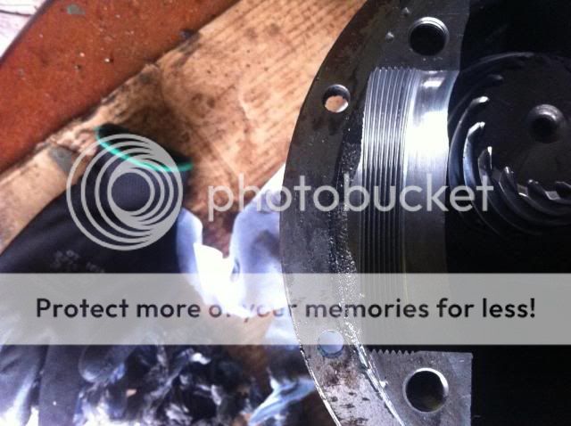

Note that I have not removed the pinion from the diff carrier and therefore the preload setting and backlash are all correct. Make sure to clean the diff carrier, especially the mounting points for the bearing caps, bearing races and the threaded parts for the bearing retainers.
Check for any high spots created during the marking of the bearing caps and bearing retainers. You can use a fine file to flatten them down.

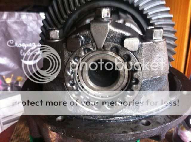

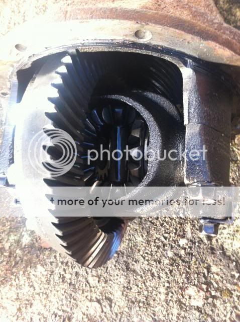

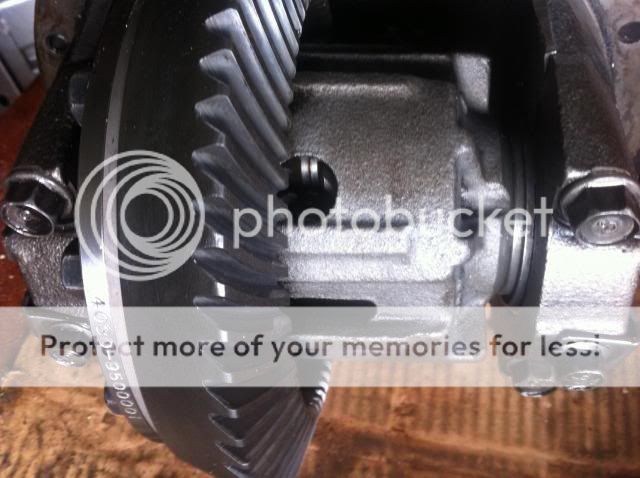

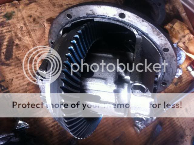

Insert the MX5 LSD centre with the bearing races into the S3 RX7 diff carrier:
Refit the bearing caps loosely and refit the bearing retainers so that all the marks line up as they were before you disassembled the diff:
Note that this is a starting point for the backlash only. It still needs to be checked as correct.

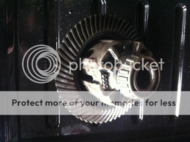

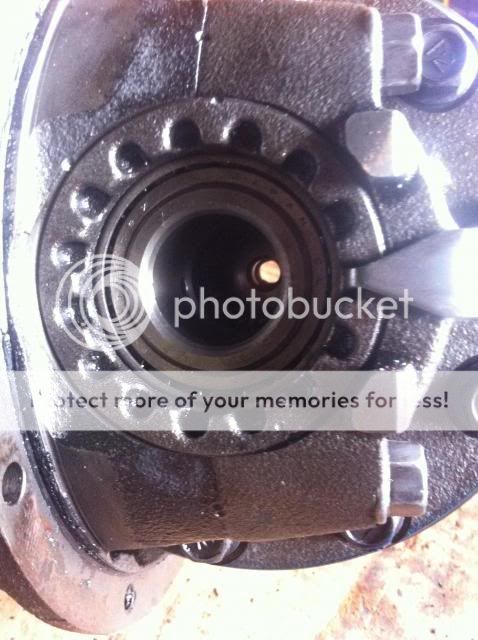

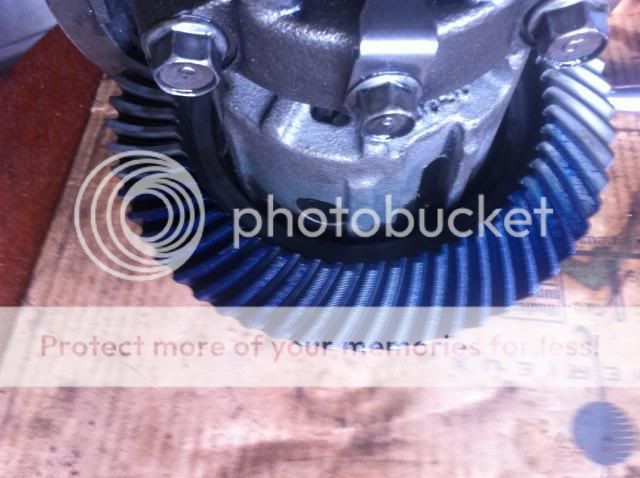

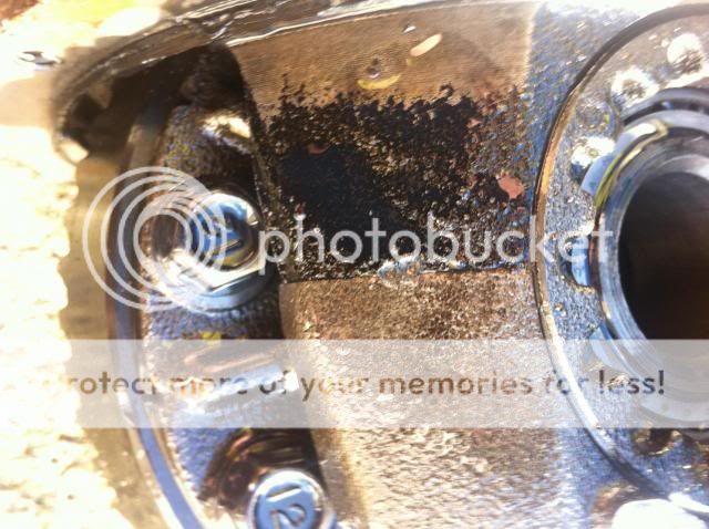

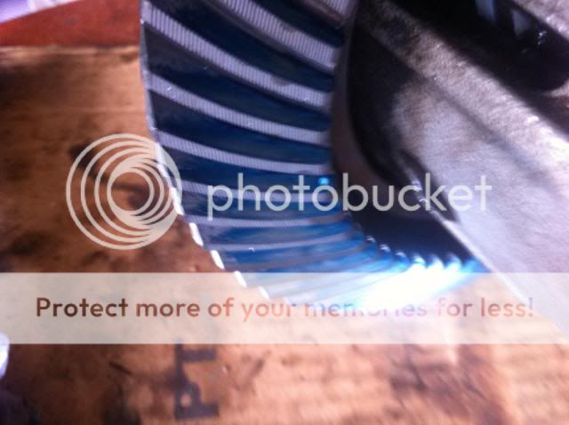

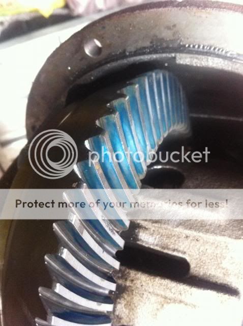

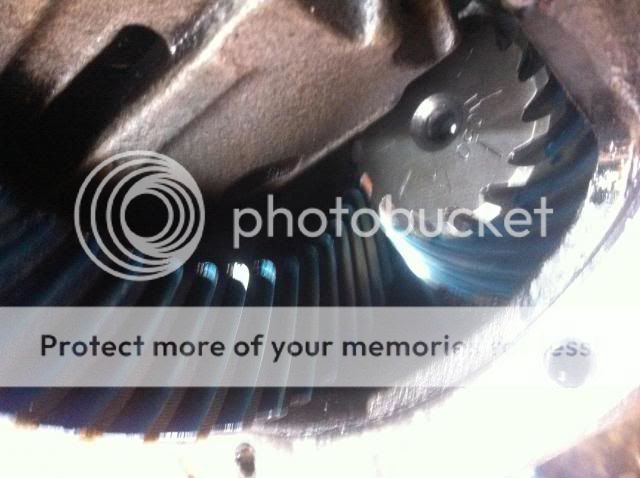

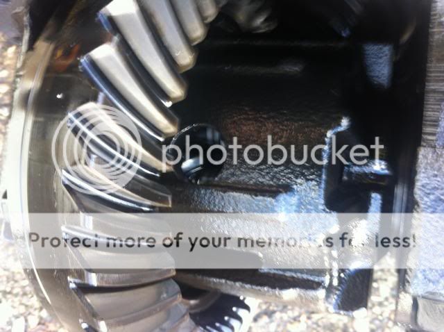

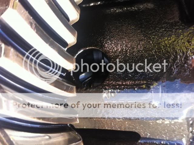

You will need some engineering ink/paint to check the contact pattern. Apply the paint to the crown wheel, allow to dry and then rotate the diff forwards and reverse and check the contact pattern. It should be in the middle of the teeth in forwards and reverse:
Setting the preload on the bearings.
Here you can see I have tightened up the bearing retainer beyond where it was originally with the open diff centre. The tighter setting ON ONE SIDE gave the above contact pattern.
I still have 2 setting I need to check; backlash on the crown wheel, which I expect to be correct as I haven’t removed the pinion and I am using the exact same crown wheel and pinion, and the distance between the 2 lugs on the bearing caps which I pointed out earlier.
I don’t have these tools at the house so I will check these when I go to my garage.
Currently, the diff turns nicely, there is slight backlash between the crown wheel and pinion and the bearing caps are back in the same location so perhaps only very minor adjustment required if any.
