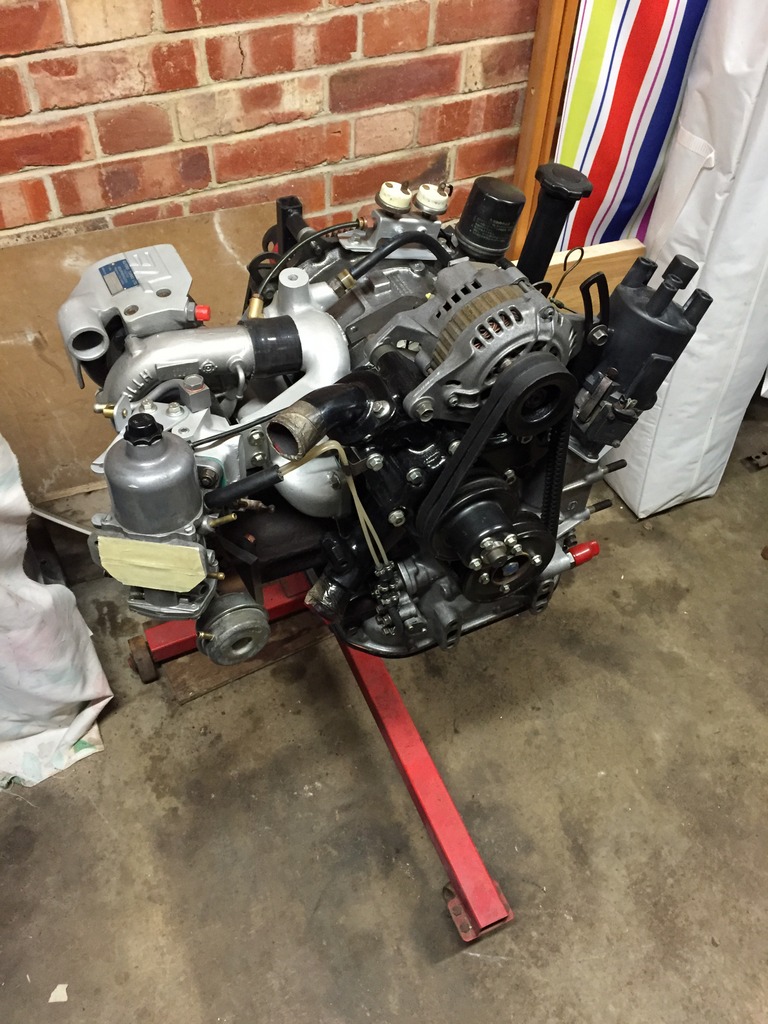

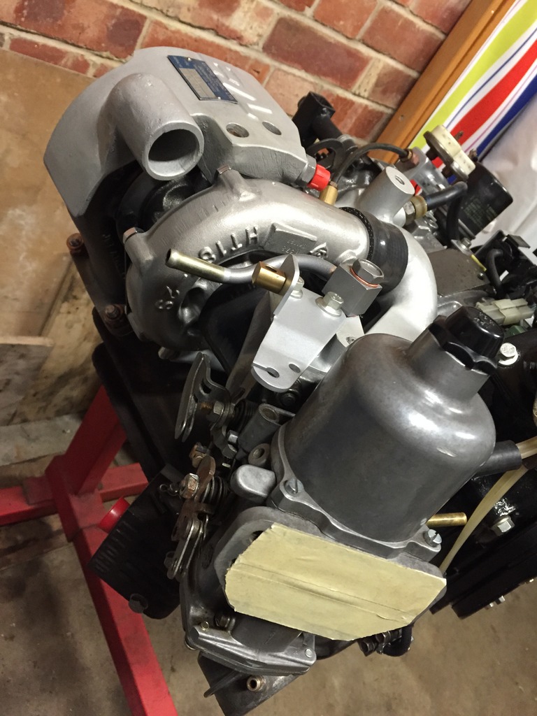

Post by kenwhiteside » Sat Jan 10, 2015 1:23 pm
Engine basically built apart from few hose clips and the oil lines. Need to get a FD oil filter pedestal as suggested for the turbo oil feed. Anyone got one lying about?
Some photos below.

Post by kenwhiteside » Mon Aug 31, 2015 8:45 pm
Finally got the old girl running

Post by TOOL » Tue Sep 01, 2015 6:58 am
I seem to have missed this one.
The car looks great. Top job on tidying up the motor, looks like new.
Let us know how she runs.

Post by spirit r » Tue Sep 01, 2015 9:56 am
Wow! Top work!!! th: do some polish to the alternator and then welcome in the club :lol:
I know Andy doesn´t like shiny things. :D Perhaps you do it!

Post by kenwhiteside » Tue Sep 01, 2015 12:33 pm
She runs OK but still some tuning to do to get the carb and timing set up right. The engine does not have the elford ignition control unit in place which makes me nervous about the on boost ignition timing. Plan is to borrow an advance timing light and set up this way. The info on this site talks about the elford unit retarding timing however all mine has is a solinoid that switches at 0.1bar that blocks off the vacuum advance. Is the circuit actually this basic?
