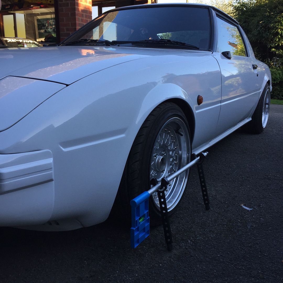

Bit of an update of non engine related stuff.
The whole car was very very stiff sprung, it had Zeal coilovers (Endless) from an FD RX7. Obviously the suspension design is completely different and the coilovers didn't work well. The spring rates are front 560ib/in and rear 615ib/in . I decided to look at the rear coilovers first. I thought changing the spring rate would be enough, I ordered some 180ib/in rear springs but when I got to fitting them I found the rear dampers were seized completely solid, so there was no suspension travel at all :? No wonder it was bouncy :lol:
So I got onto AVO and got some mk2 escort rear coilovers. They were recommended for a 180ib/in spring but in 12" whereas the zeal coilovers use a 7". The valving should be pretty good for the back of an RX7 though. I got them fitted, useing the top mount off the Zeal coilovers and used the 7" spring with the spring perch wound to the top. It works ok for now but I will get some helper springs as the springs are a bit short.
The front dampers seem to be working well but the front is far too stiff, so I will get some 350ib/in springs. I doubt the valving will be ideal but we'll see.
It would be nice to get some camber adjustable top mounts, RCAs and rear traction bracket from T3 to really sort the suspension out, but I doubt it'll. a track car so probably not necessary.
Other than that I did a quick alignment,

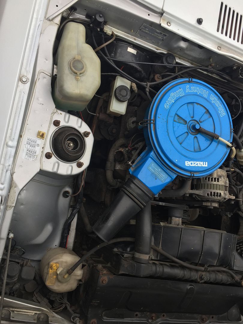

I've started cleaning the filthy engine bay, I tried to adjust the power windows but they're still chronic. Also need to order some door and window seals unless anyone has any?

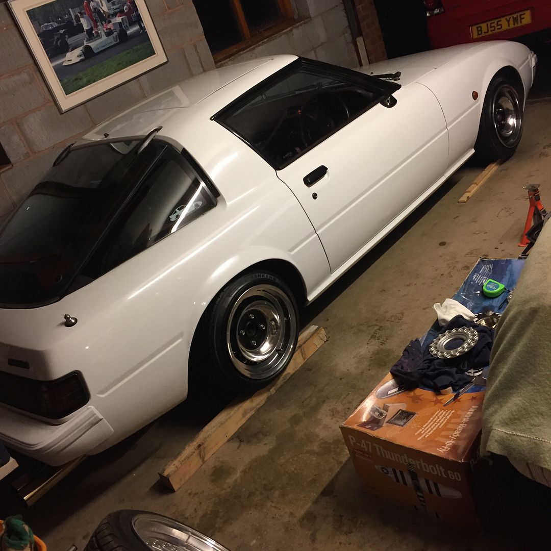

And also got some new shoes

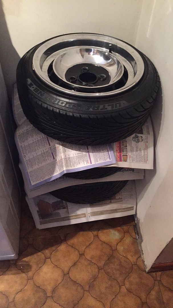

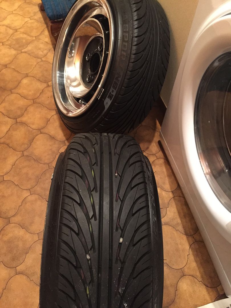

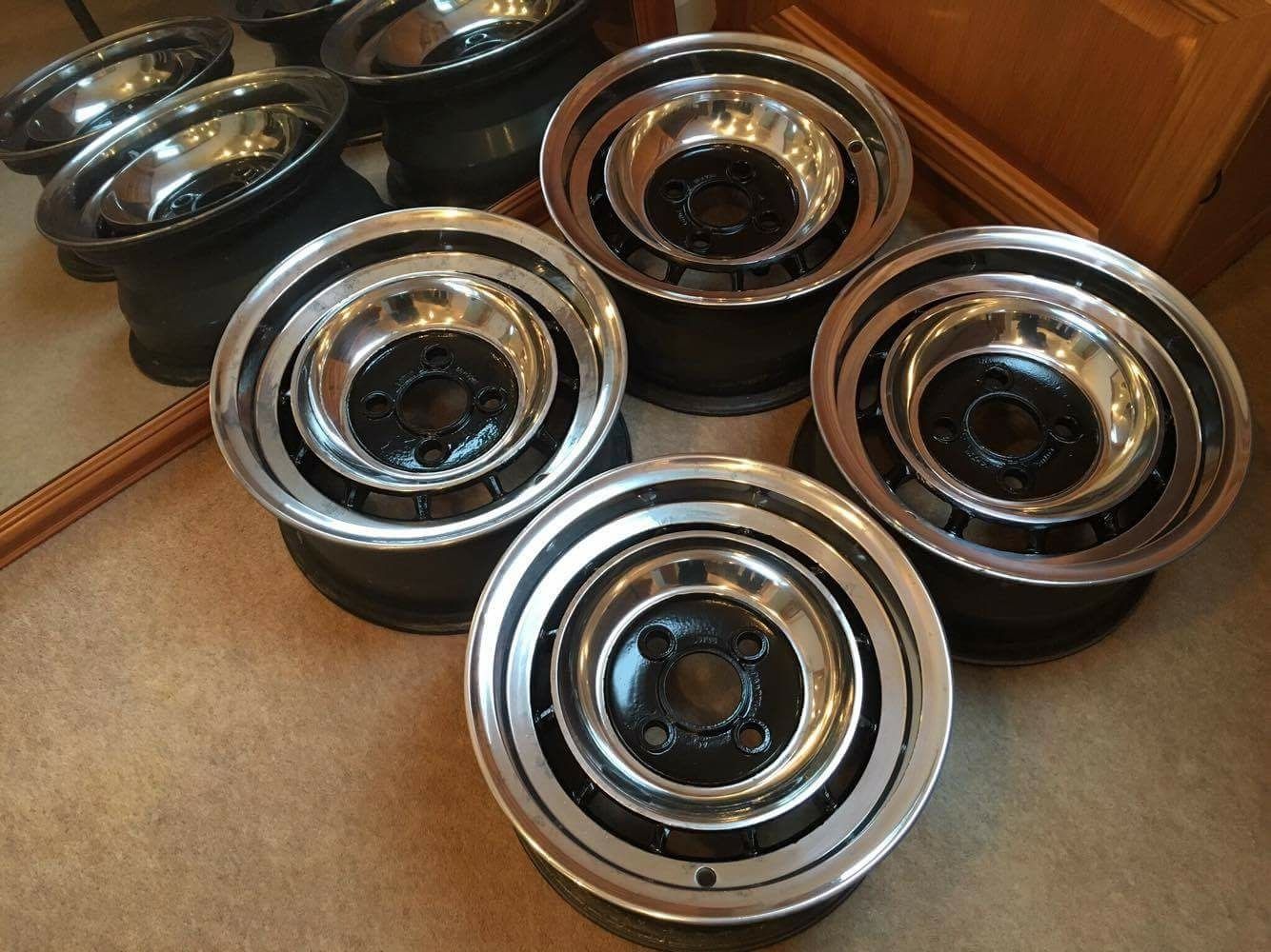

Nice choice for wheels. I've been meaning to try those .... real hard to find a set though. They don't hang around too long on RR boards. Great idea to polish them up too. I've seen them painted but they look the nuts polished up. What's the offset, I think it's around 14 IIRC?
Posts: 626
Location: Pershore, Worcester UK
Has thanked: 0
Been thanked: 0
Re: Tweety and Sylvester, Two RX7s are better than one!
Post by gt_james » Mon Sep 19, 2016 5:49 pm
I've always loved most things lotus and had a soft spot for these for a while. Et14 sounds about right, I think I'll run spacers. I would like ARP extended lug studs but not sure where I get them. I was trying to buy this set for months, they've been professionals polished, they aren't mint but look ok
