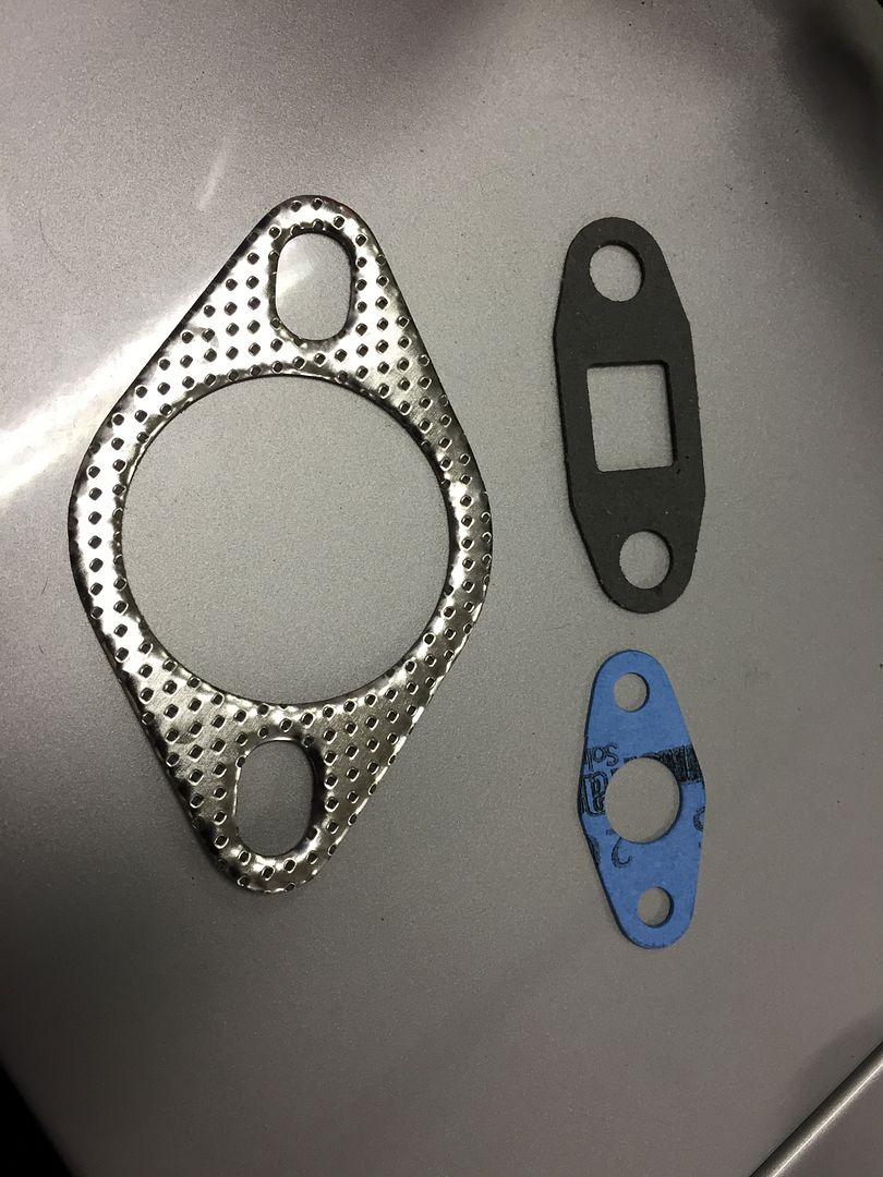

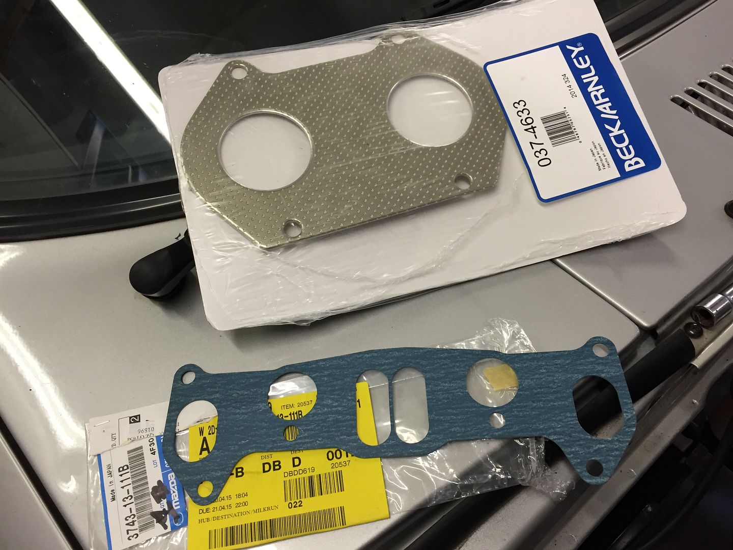

I am going to get a new engine for my Elford.
Whilst there is nothing really wrong with the original, although it has done 70k miles, the opportunity has arisen to get a better engine and I thought I would replace it before the car is finally painted.
I am not sure what gaskets and other consumables I will need to do the job.
I know Ian and Rip have rebuilt or replaced their engines with an Elford set up so they will have first hand experience, but all guidance would be greatly received.
Cheers
Kwv

Kev,
you'll need an exhaust manifold gasket from Rockauto, an inlet gasket and 'O' rings from Mazda, some Garrett turbo gaskets and 20mm stainless core plugs off Ebay...
you will also need some RTV silicone to bond the Elford sump onto your replacement engine, some proper exhaust paste ( not that crap Holts stuff) and some copper crush washers for the oil feed pipe banjo's.
Depending how far you want to go with it.... it's easier to strip out the engine bay for a really good job.... when I changed my engine, I took out most of the stuff, masked up the loom, brake lines and a few other bits that I couldn't be bothered to remove then rubbed it all down, primed it, top coated then lacquered it...
When it was all back together it looked stunning.... it's a bit more work but if the engines out then it's the best time to do it..... nothing looks worse than a fantastic new paint job and a scruffy untouched engine bay... just makes it look like it's been done on the cheap.
