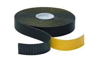

Great thread Ian, I am thinking of getting this done on my SA and was wondering where you got the foam from? Another great job as always Ian, did you blast the metal or was it a rust inhibitor, wire wheels and POR15? Thistle route I'm going down I think.

I used some of this stuff Simon....
air conditioning fitters use it and I got some for free off an a/c fitter but it can be bought from loads of places including here...
http://www.pipelagging.com/armaflex-pip ... g29s57kd75
to clean the tinware I used a wire brush in the electric drill and then gave them a heavy coat of cold zinc galvanising out of a spray can
if you have the opportunity to take the heater box out and refurb it, it's well worth doing..... it's surprising how they deteriorate... as a test, look at your heater box and you will see the bottom flap just inside the heater box. Run your finger over the foam on the flap and the chances are that it will just turn to dust.
