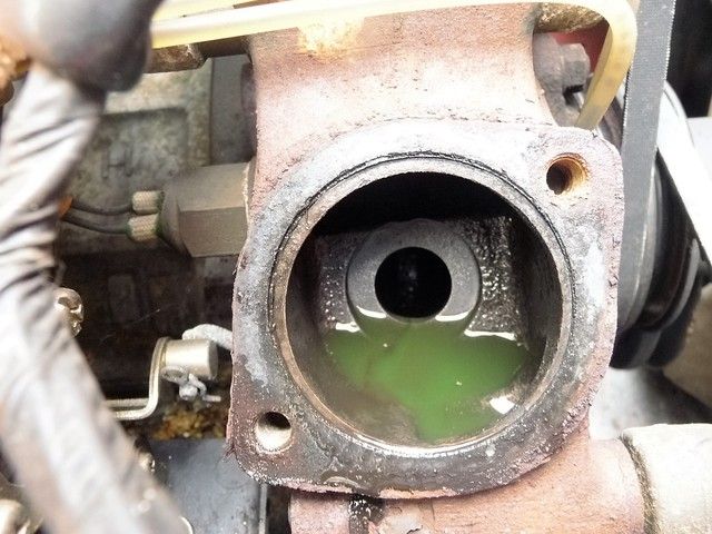

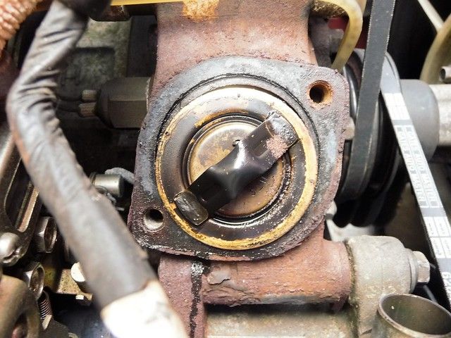

I've now fitted the new themostat and flushed out the system using dish washer tabs.
when I removed the housing it looked clean, as far as I know this is the first time this has been off.

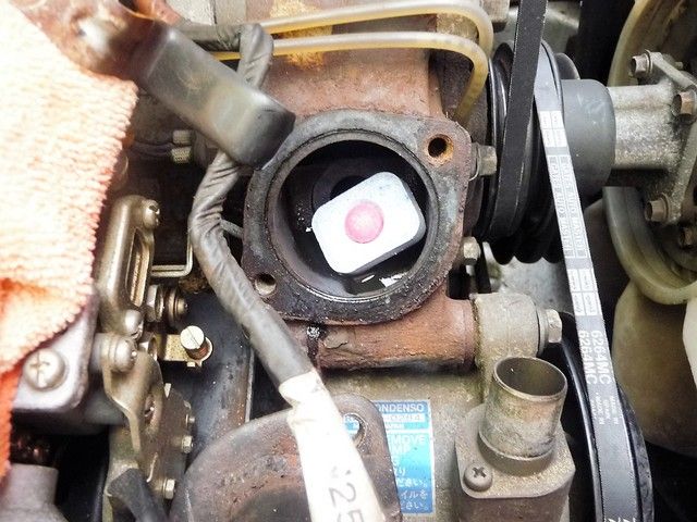

I then added the 2 dish washer tabs one in the housing and one in the rad, refitted the housing ran and drove the car for about an hour with the themostat still our.
