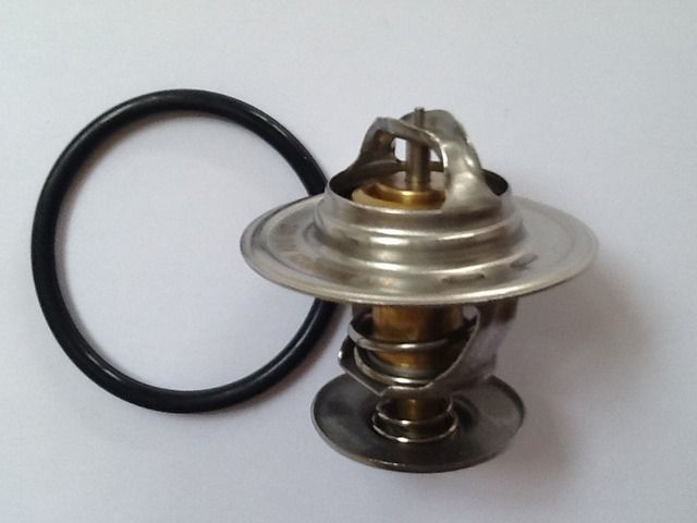

Hi All, this is what turned up today, it has 82 degrees C on the top.

Just make sure it clears the outlet properly. If they sit too high, you won't get the outlet bolted down over the top of it correctly.
The FC outlet has more space over the top of the thermostat.
Don't use the rubber ring.

Thanks Andy I'll chk it against the original one when I take it out. it's off the road from 1st Sept so I have plenty of time.
