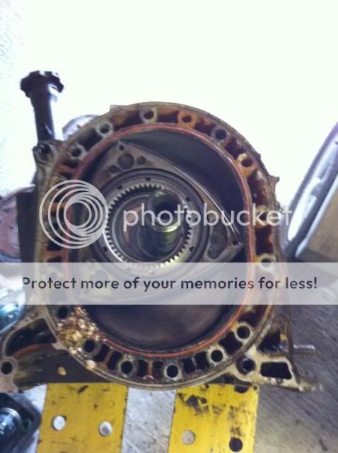

It'll look like this on the inside:
This one's not too bad. but I've seen them gummed up all the way round the bottom galleries.

I had a feeling someone was going to tell me that....
First step, sort out the Rad and see how the temps and that look from there as the motor is running Sweet at the moment.
