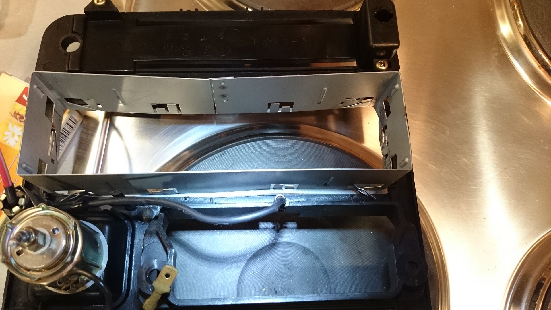

I have delved into the dark art that is wiring and electrickery. The lighter has a power wire with a female bullet connector that fits on the end of this rather bent male connector and a black earth with a spade connector
There is another black wire with an odd shaped bullet type connector
So far as I can tell, the only logical place for this to go is between a couple of retainer guides ....
And into here. Maybe an earth for the factory cassette player?
Or I could be completely wrong :oops: Suggestions anyone?

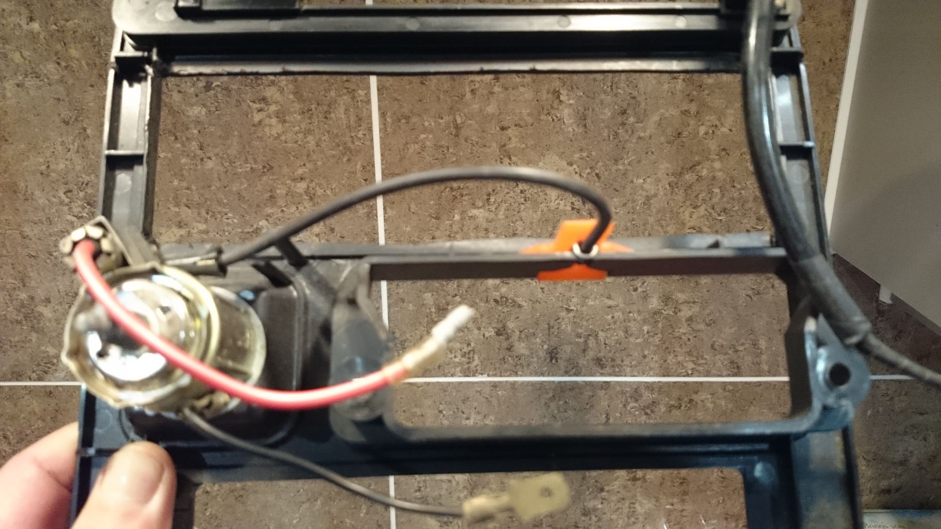

If I remember right that's the light for the ashtray.... a sort of fibre optic type lead.... turn your lights on and have a look

Bonus points awarded Ian. I've just pulled out my spare facia. My current one is missing the orange 'filter'. Image
