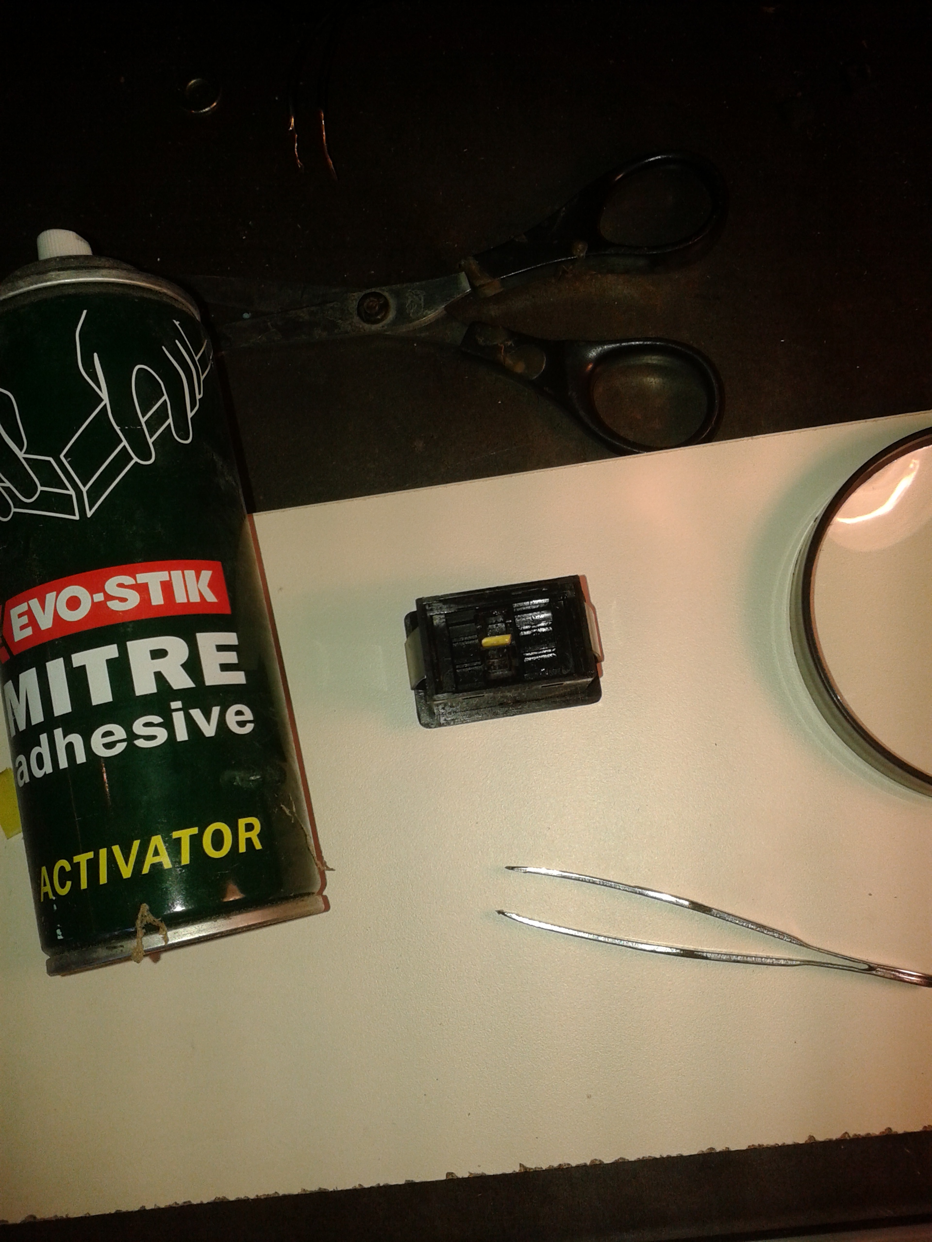

well heres my tale drivers side window switch was broke inside small piece of plastic that holds spring that pushes plastic and small runner down onto switch contacts i cut a bit of plastic off a box and glued it in place (wifes tweezers came in very handy

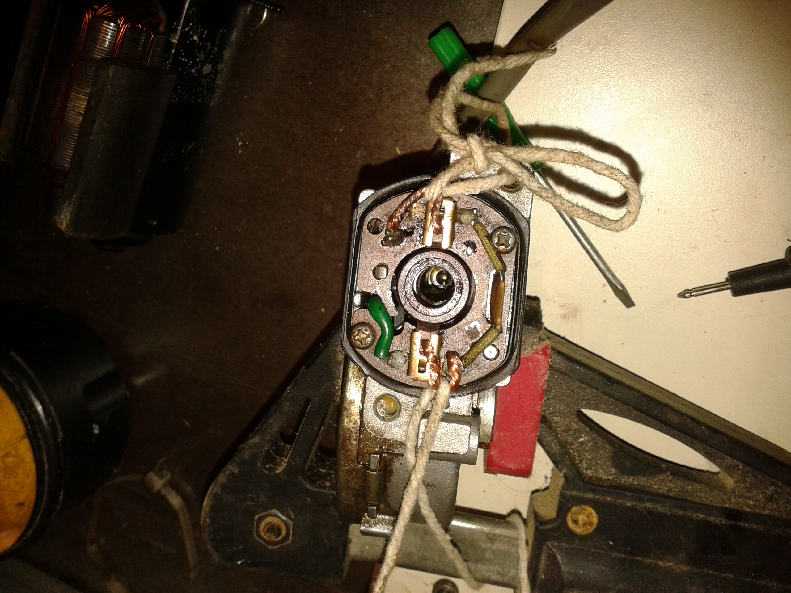

then hoping to find same kind of problem for passenger side decided to try to get passenger side working (it was nt working when i bought car)

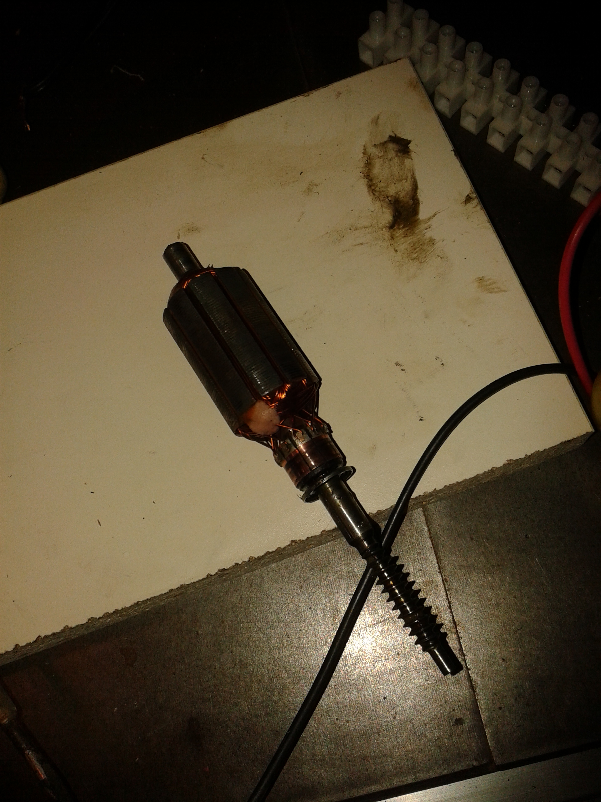

after a clean, switch was sending power but no movement so had to remove motor but no movement as motor was siezed up so took motor apart
my phone 173.jpg (1.85 MiB) Viewed 869 times
and it was rusted up on inside so cleaned all rust greased all bits cleaned with petrol and prayed also greased drivers side runners and now both windows work great
