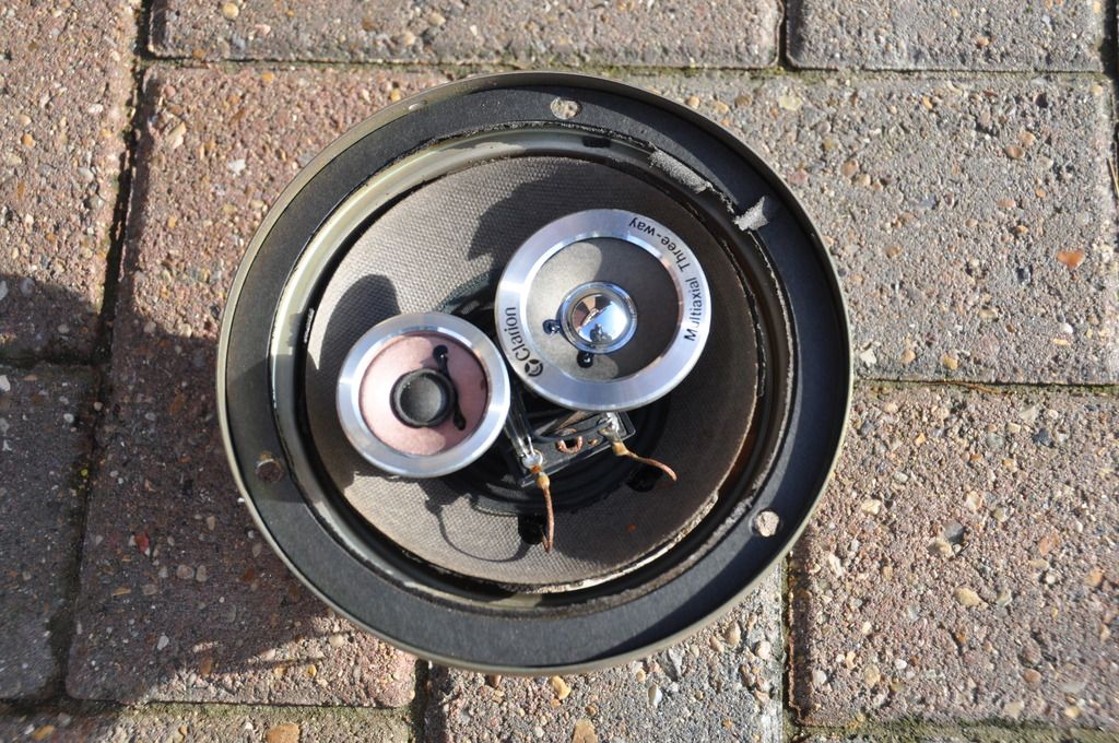

Looking to replace both my rear speakers, whilst the rear side trims are out to sort out my shocks. The foam cone surrounds have completely disappeared - no great surprise, given their age. However, I'm confused as to what size speakers I need
This thread starts off suggesting 6-6.5" speakers, yet I just measured the aperture and it measures just 5"?
On the other hand, the speaker I took out says "16cm woofer"; 16cm is about 6.3". Yet the maximum overall diameter of the old speaker is 15.7cm and the speaker "cone" itself is no more than 13cm
Is it normal to exaggerate the length, sorry, diameter
of speakers in this way
I saw these 6.5" JBL speakers on Amazon at a reasonable price (I'm not after the ultimate in sound quality!)
https://www.amazon.co.uk/gp/product/B00 ... ROKL5A1OLE
They are 4ohm and 50W RMS, so seem technically OK, but I eventually found the dimension data which stated the aperture required is 5 and 5/8 inches, so too big.
Pete's post above with an ebay link looked hopeful, but the item on that link is no longer listed.
Can anyone recommend a pair of speakers that will definately fit? I'm happy to resolder the connectors if required, but I don't want to go hacking at the car bodywork

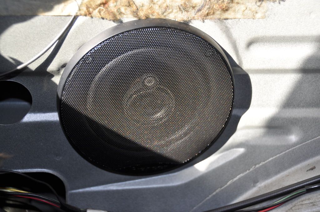

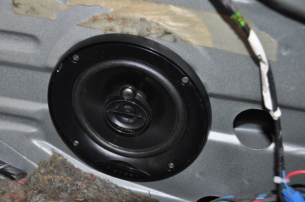

After a lot of pondering I settled on a pair of Pioneer TS-G1333I speakers, just £27.50 delivered from Amazon. They have a 13 cm cone, so slightly smaller, but the overall physical dimensions looked good. The speaker spec was similar; 4 ohm, 35W nominal power, 3 way type). Got them yesterday and fitted them today and it turned out to be a doddle!
The 4 screw holes lined up with those already on the car, and the new self tappers supplied with the speakers were perfect. The electrical spade connectors were also identical. Here's the driver's side fitted;
Passenger side, with the mesh clipped back on to provide extra protection;
The sound is fine - nothing spectacular, but good enough, given the poor mounting enclosure.
Certainly better then the originals, with perished foam
