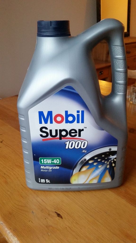

I've been using Mobil Super 1000 mineral oil since I got my car. Just got some more today from Halfords actually as I'm due an oil change
