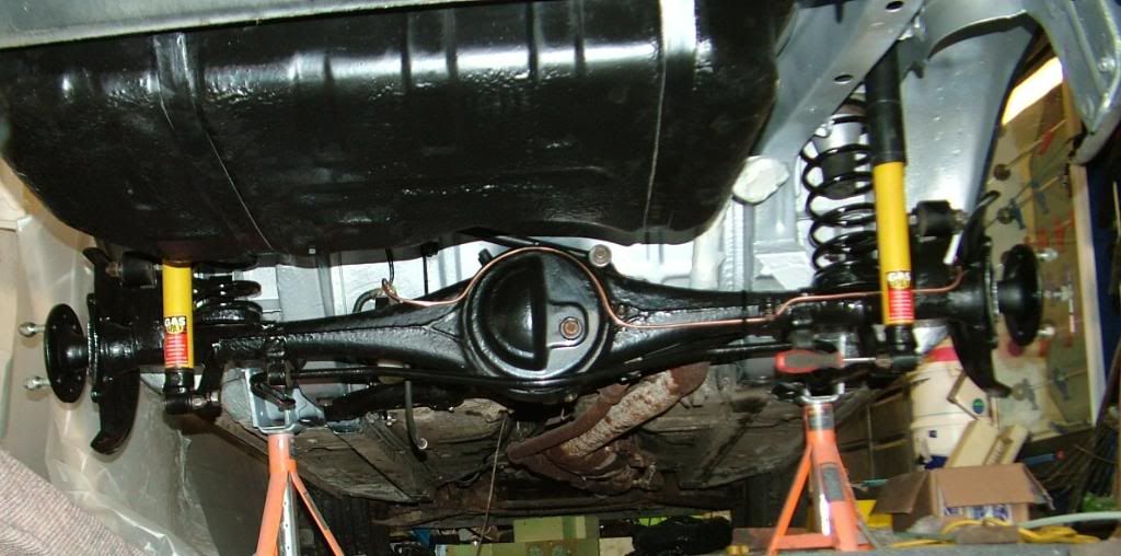

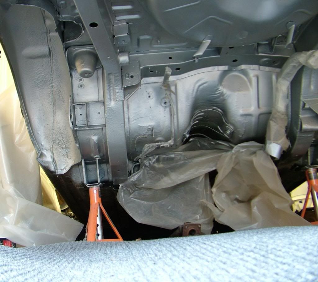

Trouble is, it's not just where to jack it, it's where to support it too. If I want to change the suspension (which I do) I obviously can't put axle stands under the actual rear axle beam like Dave suggested cos then I can't get the springs out (presumably). So it looks like the chassis rails right at the veyr end are the best bet? Or these radius arm mounts, whatever the hell they are

Post by ian65 » Sat Mar 17, 2012 10:07 am
here's the lower rear radius arm mount... that's the best place to put your axle stands...
chock the front wheels, jack it up under the diff, slide the axle stands into position and then release the jack... as long as the ground is ok, the car should be very stable and safe to work on.

Re: Jacking
Post by Lucky » Sat Mar 17, 2012 10:17 am
Perfect, thanks Ian. A picture speaks a thousand words :D
