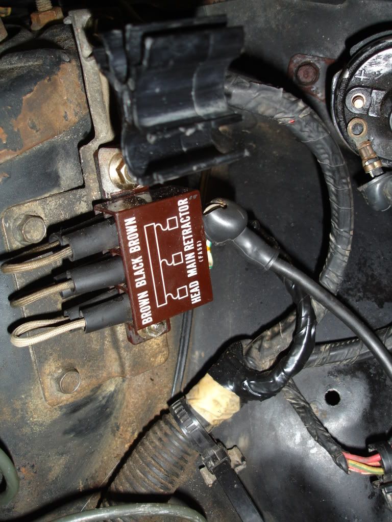

the main positive supply to the starter comes directly from the battery.... it might be the signal wire that's not supplying the signal.... turn the key into the start position and check the voltage across the signal wire ( the one that goes onto the small spade connection) .... it should be +12v. If, when turning the key to the start position, you don't get any voltage out of this wire, check the main fusible link on the nearside suspension tower under the bonnet..... the link in the centre in this picture....
the starter signal +12v goes through this link.
