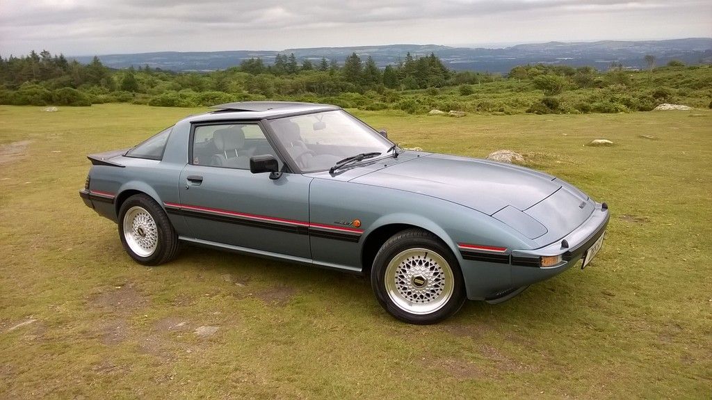

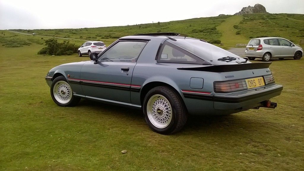

Well I "Bit the Bullet", "Seized the moment", "Grabbed the bull by the horns" & bought some wheels (after fannying around for ages). 7J x 15 ET 30......................Falkens all round, 205s on rear & 195s x on front x 55R:-
Surprising how much better the steering feels with the 195s

I think they look really smart.
Is the steering easier or more precise with the new boots?

Steering is lighter & feels better at speed.

they look great Pete, you didn't have to mod anything or use spacers then?

No mods :D Had to buy new wheel nuts as the stock would not seat properly, jury is still out ref the black studs :?:
They may end up blue or silver yet?
The centres are only plastic & the Chrome plastic BBS can be removed.
