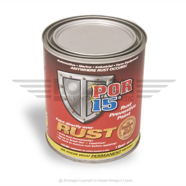

UK suppliers for POR15:
these are the ones I use.....
Holden for satin finish black (S/G)...
http://www.holden.co.uk/displayproducts ... int+System
and Frost for gloss finish black...
http://www.frost.co.uk/catalogsearch/re ... tAodunUYyw
nothing to choose between them really in terms of price or delivery times.
If anyone knows any other suppliers of this stuff, please post it up. I can only find it mail order.... it would be nice to be able to get it off the shelf somewhere...
